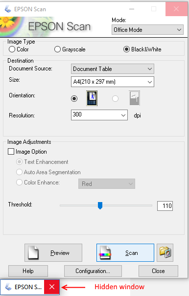

My epson perfection v700 scanner (that allows me to scan photos, negatives, documents, etc.) and that I paid over $800 for) stopped working with teh latest update two days ago. I've downloaded a new driver and other software from Epson and it doesn't work. Can I uninstall this update? I like my scanner a whole lot more than I like Windows.

    After a (epson) scan, a window would disappeared off-screen (behind the start menu) and would not return.
    Epson Scan has to be killed with task manager.

    I have been in contact with Epson on this issue on my V600.  Their latest fix i received today was to run a small utility to remove the Epson driver and clear registry entries.  They then have you delete temp files, etc and reinstall. While the fix only partly works, it is better than before.  It does not lock up anymore.  If you minimize the window it will go down to a small bar of some type that can't be brought back up.  but you can close it without killing the process.  So my rule is now to not minimize it!!
