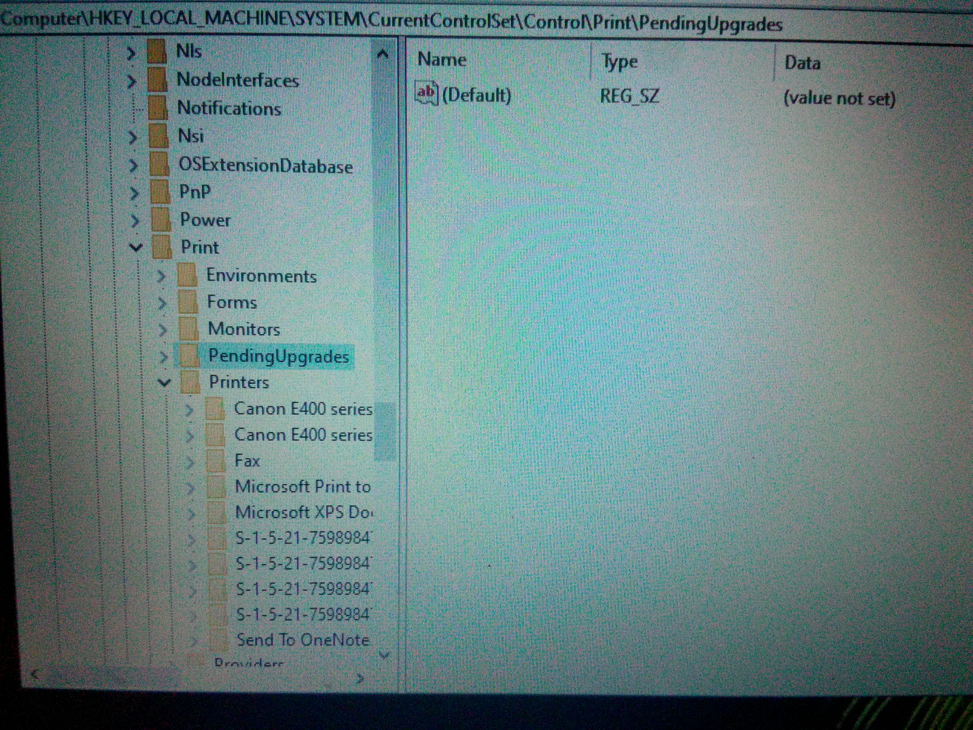

    I have been having the same struggles as the person in the initial post. I tried doing what you recommended and I am unable to find that registry subkey. Do you have anymore suggestions? I am not super tech savvy so I need all the suggestions I can get. I even went as far as getting a different printer but all the error messages are the same. I even spent 3.5 hours on with windows support with no luck. I am officially frustrated and looking for any ideas.
    Thank you!
