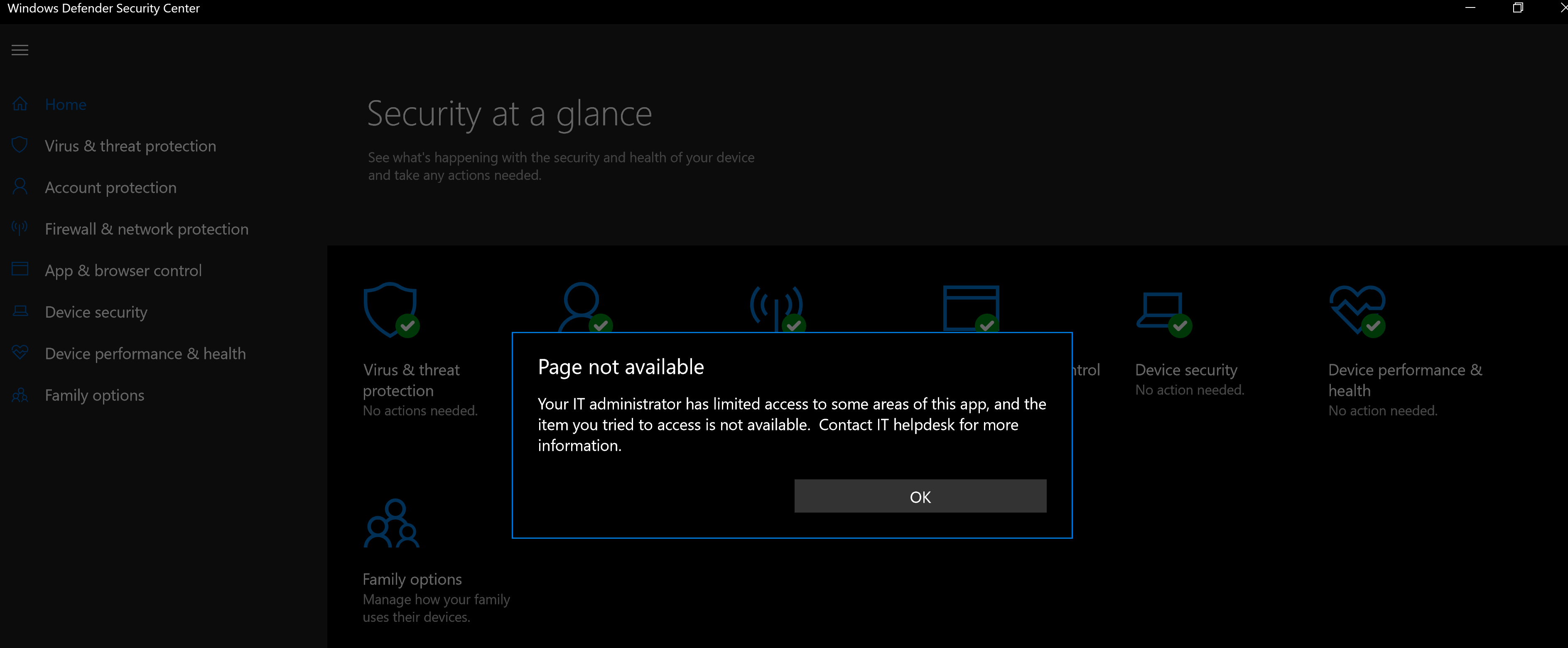

Your IT administrator has limited access to some areas of this app,and the item you tried to access is not available . Contact IT helpdesk for more information.
this is the message I get when I try to scan a drive using windows defender(right click and scan using windows defender option).
windows specification:
edition:windows 10 home
version:1803
os build:17134.48
device specification:
hp envy x 360 convertible

Hi Michael,
I believe that your IT department is right.
It is probable that the problem in v1803 is associated with the "Periodic Scanning"
button. Please see my posts in this thread for August 27 and 28.
I think there is a fault in v1803, that leaves only some PCs without a functioning
periodic scanning button.
In other threads, some have had this same problem, and their button was turned on.
Yet, when they uninstalled their third party anti-virus, there problem was corrected.
A functioning periodic scanning button allows Windows Defender to work in concert
with third party anti-virus programs.
EDIT:
I did not have this link in hand when I first replied to your post.
This link is my case in point.
Andrew had the same problem, that was originally expressed in this thread.
He had also been successfully running a third party security program, in concert with
Windows Defender, until W10 v1803 was installed. And his periodic scanning button
was turned "ON".
https://answers.microsoft.com/en-us/protect/forum/all/why-is-scan-with-windows-defender-blocked-by-it-on/33f9ab1b-673d-4eb9-8119-ce0d92a2cd83#
Pay particular attention to the second page of his thread.
Regards,  Glen

    I too am having this exact fault.
    In addition to this, when I try to update, I run into the following error:
    Definition Update for Windows Defender Antivirus - KB2267602 (Definition 1.271.1003.0) - Error 0x80070643
    I dug around and thought this may be because of corrupt data. Having run CHKDSK I can see this isn't the case.
    On the off-chance that either 'Spybot Search and Destroy' or 'SUPER ANTI SPYWARE' would be throwing a spanner in the works, I've uninstalled these.
    I've checked the group policy and ensured that option 'Turn off real-time protection' is set to 'Disabled'.
    https://answers.microsoft.com/en-us/windows/forum/windows\_10-update/definition-update-for-windows-defender-antivirus/a2537eca-c477-43d2-9dfd-4642d0799880
    I've gone through all the troubleshooting in this thread too.
    The Windows Update Troubleshooter did detect some faults which were fixed, but the definition update is still failing to install.
    Realtime protection is still greyed out. When I right click the Windows Defender Notification Icon and click 'Run Quick Scan' I continue to encounter the original error 'Page not available' etc.
    Following the troubleshooting tips on: https://answers.microsoft.com/en-us/protect/forum/mse-protect\_start/installation-error-0x80070643/908fad3e-f9fc-4d8a-be83-ae7d3bc48db5
    I already have the Windows Installer service running
    I'm about to try Selective Startup.
    The links on that page don't work but I'm assuming it's referring to 'Diagnostic startup' from within MSCONFIG ?
    If anyone has any other tips, I'm all ears.

    Permissions; can be lost, do to viruses or hacking. You will have to reestablish permissions again.
    Check the internet on how to do that. I would offer a solution, but it would cause more problems than not, to the unexperienced.

    Is your PC part of domain?
    no,its my personal pc
    Do you have any other Anti-Malware software installed?
    yes,avast free anti virus.
    Since when this problem started?
    no sure, may be since version :1803
