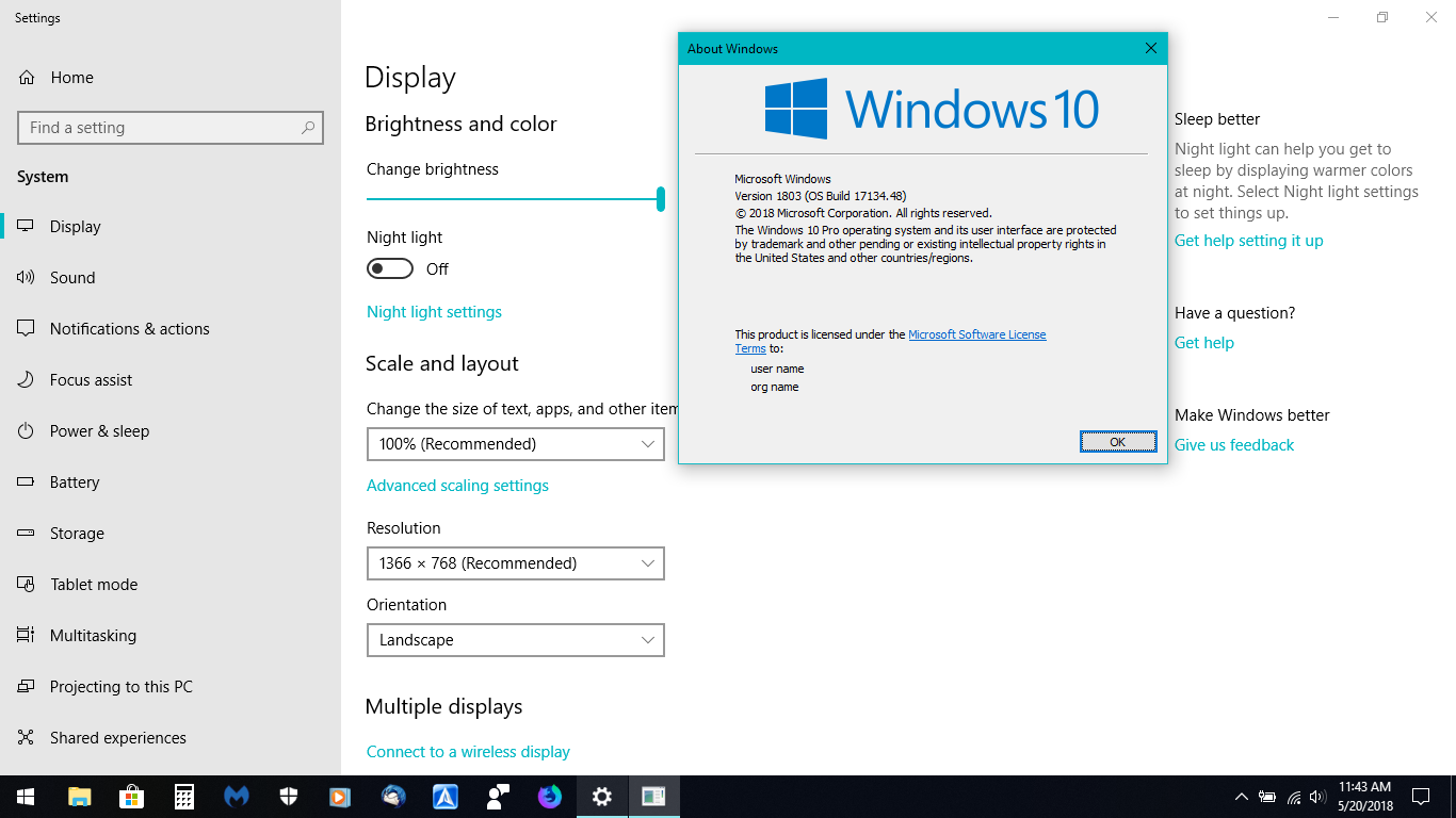

    2018-05-20T18:49:28+00:00
    You talked to a tech that did not know all.
    Here is a screenshot from one of my laptops.
    2018-05-20T20:57:17+00:00
    He tried to re-install the mouse/keyboard drivers... I told him it's not going to work and it did not work. Yes, I know the slider is there but it doesn't work.
