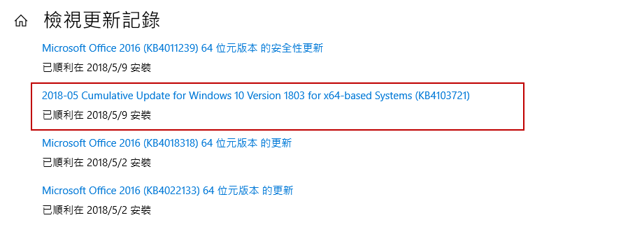

This update has some serious issues, specifically. Do NOT install this update after updating to Windows 10 version 1803. It will prevent your computer from booting up. I am stuck on the spinning circle for a long time. I have to use a Windows 10 USB to boot into the Troubleshooting and use Command Prompt to boot into safe mode. Please fix this update!
