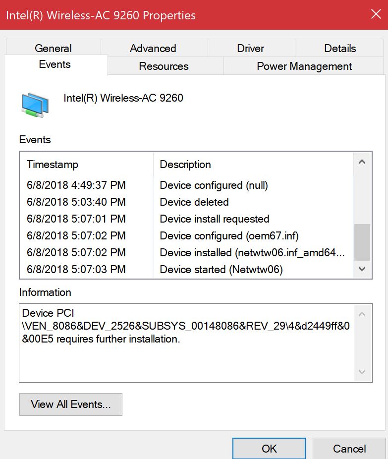

    Does your system show something like this in Device Manager-properties of the network adapter and Events tab?  Note all entries are on 6/8 which is when I installed the device.  Nothing today as far as losing the connection or reinstalls.
    I have seen many threads about a wireless device not being able to maintain a connection or re-establish a connection.  On instance I have seen is on a Dell 13 9370 which has a Killer Wireless 1435.

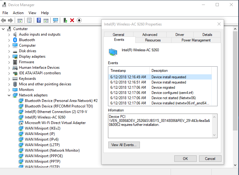

    2018-06-12T09:10:26+00:00
    This is what mine shows. I see that I don't have a "device started (Netwtw06)" as the last event, and my "Device configured" has "(oem4.inf)" instead of your "(oem67.inf)"

    I am not sure I would agree with all the changes you made.  I have seen comments regarding the Microsoft Wi-Fi Direct Virtual adapter but make sure and keep a listing of what you did so you can undo it when needed.
    I tried using the command you may have used to create the wlan report but mine would not complete.  Not sure why but it tells me I need to have admin permissions, which I do have already.  The command does complete on another system that does not have a 9260.
    netsh wlan show wlanreport
    The number of the OEM.inf file is not important and you can read it in notepad.  Look in the Windows\INF folder to find it.  It will show what company created the file.
    Otherwise, the listing you show and some items in the listings my be a sign of a problem or possibly the result of a problem.  I still do not understand why you were having the initial Blue Screens.  Your motherboard's manufacturer community forum might be the best place to discuss that original problem.
