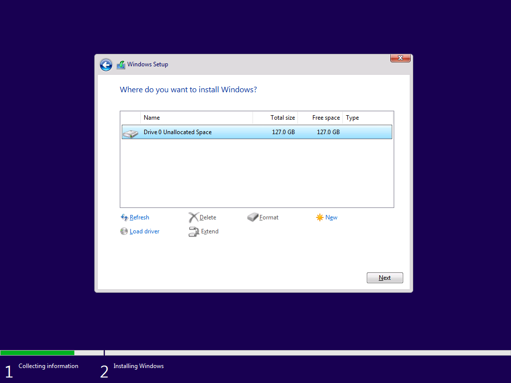

    2018-09-22T22:50:05+00:00
    Yes, that "where do you want to install" picture is showing a completely empty disk. And I like seeing the word "unallocated" instead of "free" there. It means Windows is dealing with a GPT instead of MBR style disk. That's a solid indicator BIOS is set in UEFI mode & the installation media was booted correctly.
    But all you needed to do there was to select the unallocated space, then click "Next". Setup would then create all the partitions necessary & give the Windows partition maximum space. But it does look like what you did resulted in the same outcome. Still - I would want to try it without clicking "New" next time. It is "foolproof" that way, Greg Carmack says in that URL I cited.

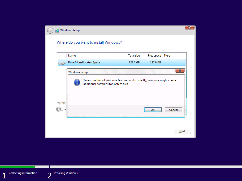

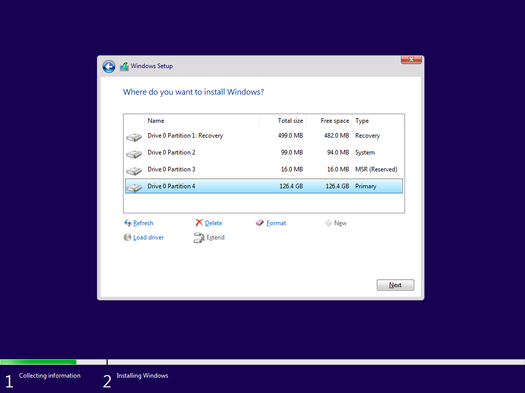

    2018-09-22T04:56:31+00:00
    First of all... at the screen...
    This is a completely empty hard disk drive, yeah? I want to create a partition of maximum size, so I click "New".
    As you can see, it it telling me that Windows is going to create three extra partitions from the amount of space I selected. These are the three system partitions I had mentioned ambiguously prior to this point.

    (3) You didn't answer - when at the "choose a partition" screen, you deleted all the partitions to unallocated space. Did you then try to create partitions of your own? I think it best just to select the unallocated space & click "Next".
