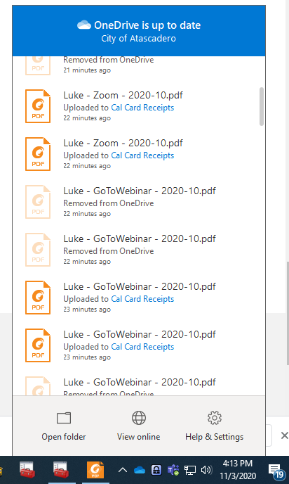

    2020-12-07T04:49:52+00:00
    Yes, this is also what we have seen but it is the PDFs that are deleted. We have reset OneDrive, re-installed it but still experiencing the same problem.
    Very frustrating since more than one person works on these folders. I will look into doing it through Teams.
