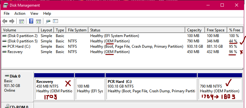

    2018-05-06T19:41:56+00:00
    I don't know about 11 GB. That sounds like a manufacturer's OEM recovery partition. I had one of 8 GB that was deleted with a clean install of 1703. And it created a 450 MB recovery partition at the front of the HDD. Then, an upgrade to 1709 deleted the WinRE.wim that was in it, & created a new 790 MB recovery partition at the end of the drive with its own WinRE.wim inside. Now the upgrade to 1803 has changed both of those to type OEM. But it gave me no new letters, & Shift+Restart does boot to it. I'm glad it didn't create a new recovery partition - but has just taken over the 1709 one for its own use, judging by the dates inside.

    Here is the 1703 recovery partition. There is no WinRE.wim inside, & the dates are old...

    2018-05-06T20:23:31+00:00
    Yes, the 11GB partition was from the original OEM configuration.   It holds certain images for doing a factory reset.
    Of my three systems with the same configuration, the only one which did not jump to the larger partition is one which has an 852 MB Recovery Tools partition.  Maybe that one was large enough so it did not need to move to or create a larger partition.
    It also cleaned out the 450 Recovery Tools partition, no folders or files left.
    The reagentc /info command will give you the path to the winre.wim
    \?\GLOBALROOT\device\harddisk0\partition6\Recovery\WindowsRE
