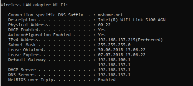

  2. Pauli O 16,380 Reputation points Volunteer Moderator
    2018-06-30T10:34:04+00:00
    That's odd. Have you check from manual isn't there any settings in OPPO to change Wi-Fi hotspot to use DHCP Server to provide addresses to clients?
    On my Lumia situation is quite opposite: I don't know if I can set it's hotspot to use static addressing, it's always create mshome.net using IP-space 192.168.137.xxx.
  3. Deleted
    2018-06-30T18:46:50+00:00
    Pauli O: Dynamic IP addresses on the router was what caused the problems in the first place
    No, not really. The *change* of IP address caused your problem. Normally, a router will always reassign the same IP address to the same PC. If it didn't do that for one PC there was a problem either on the PC or the router (troubleshoot that, maybe a clash of addresses or a malfunctioning network card).
    Your other problem with the mobile hotspot is just the opposite. Because you stopped using DHCP it cannot assign you a working IP address anymore. You may be able to fix that by checking what net and internal gateway your hotspot device uses and then use the same net and gateway address on your router and home network.
    Might be easier to go back to DHCP for the home network and find out why the address always changes on one device after a reboot/hibernate (if that really is the case or just an assumption on your part).
    You will hit the same problem each time you want to enter another WLAN and you have no DHCP.
