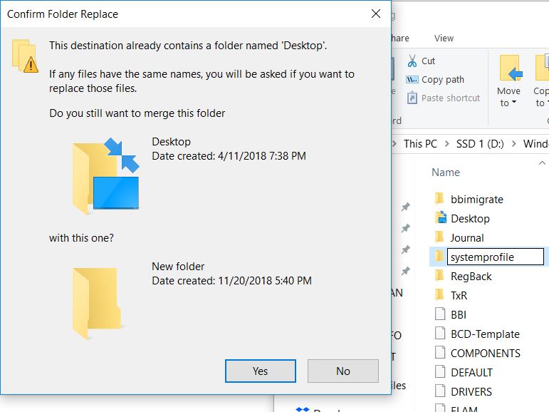

    I had/have this same problem so I took out the C: drive and plugged into another computer. I navigated to C:\WINDOWS\system32\config\systemprofile\Desktop and discovered that the systemprofile folder didn't exist. I did see the desktopfolder, but it was in the config folder, so a level up from where it should be. I figured I'd make a systemprofile folder and drop the desktop folder into it to see if that worked. However, when I went to try it, I got this crazy message:
    As you can see, I was attempting to rename new folder to systemprofile, but it was giving me a warning that there was already a folder named desktop, even though I didn't type desktop! This made me think that somehow it was labelled incorrectly internally. Sure enough the missing folders are indeed within the desktop folder (including another desktop folder). Instead of making a new desktop folder, I renamed the parent one to systemprofile. I haven't plugged the drive back into it's machine yet, but I am hoping this will fix the issue.
    2018-11-21T02:40:13+00:00
    Okay, this looks like it is working. It will remove all files installed that didn't come with the computer but keep my personal files (so it says). It looks like I won't be reinstalling McAfee, as it appears the virus detection programs are to blame in most cases. Looks to me like Microsoft would have windows check for a third party program and say it needs to be disabled.
