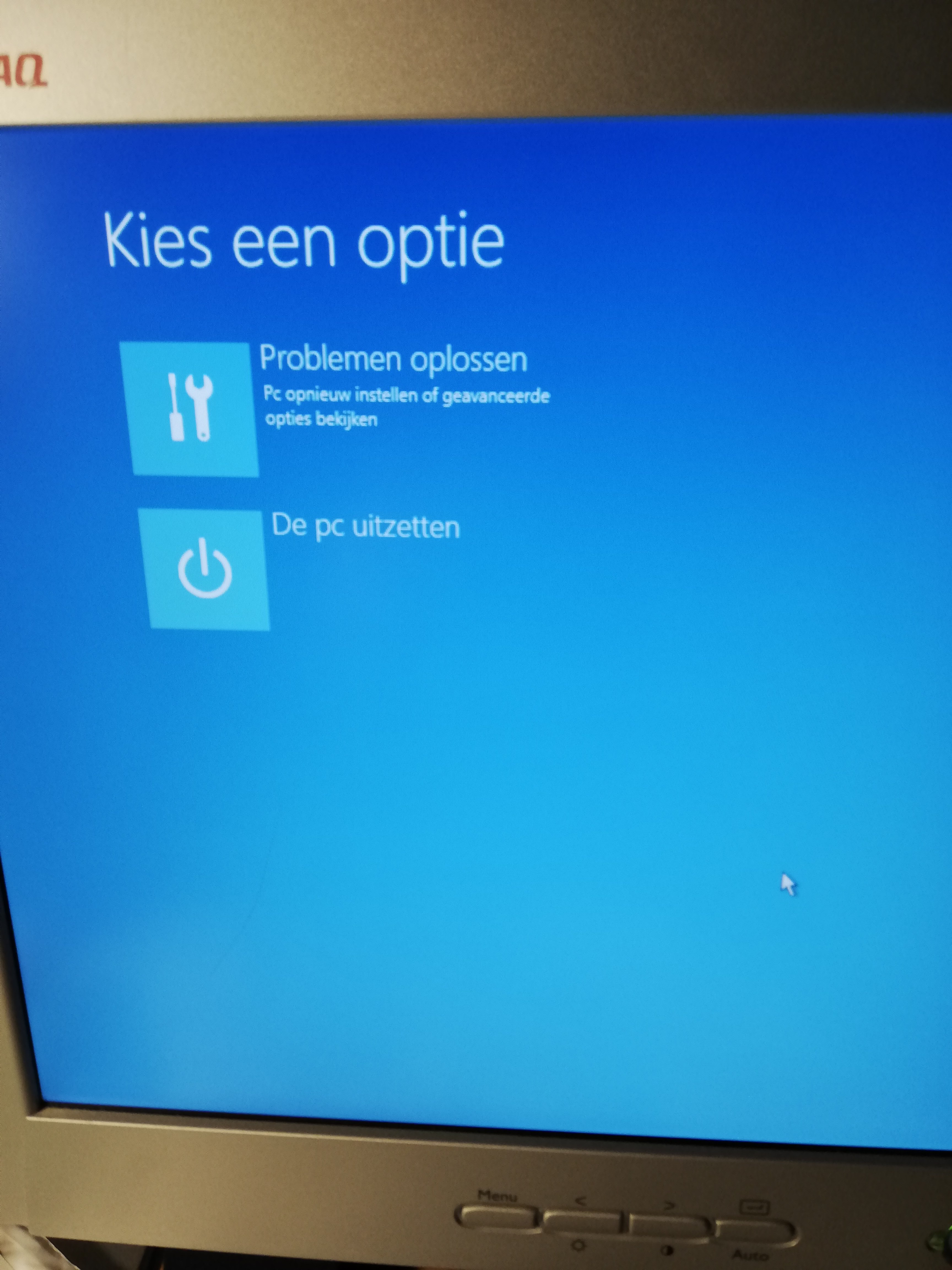

Mediatool boot:
  • This PC can't be recovered with start-uprepair.
  • You need to choose which installation of Windows you would like to put back when using Systemrecovery.
  • Reboot, select a operating system and select Systemrecovery. No systemcopy available.

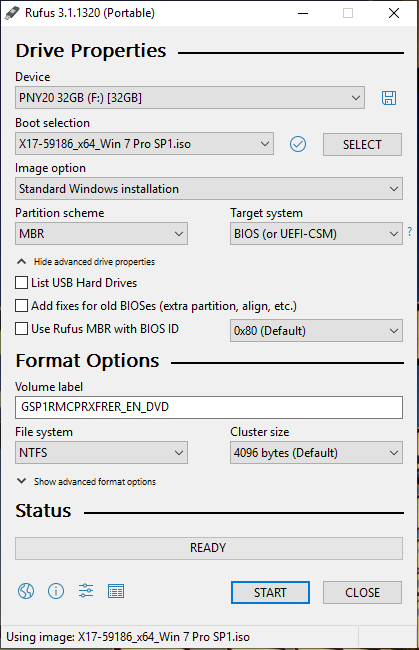

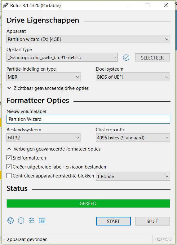

    How I created the drive in RUFUS:

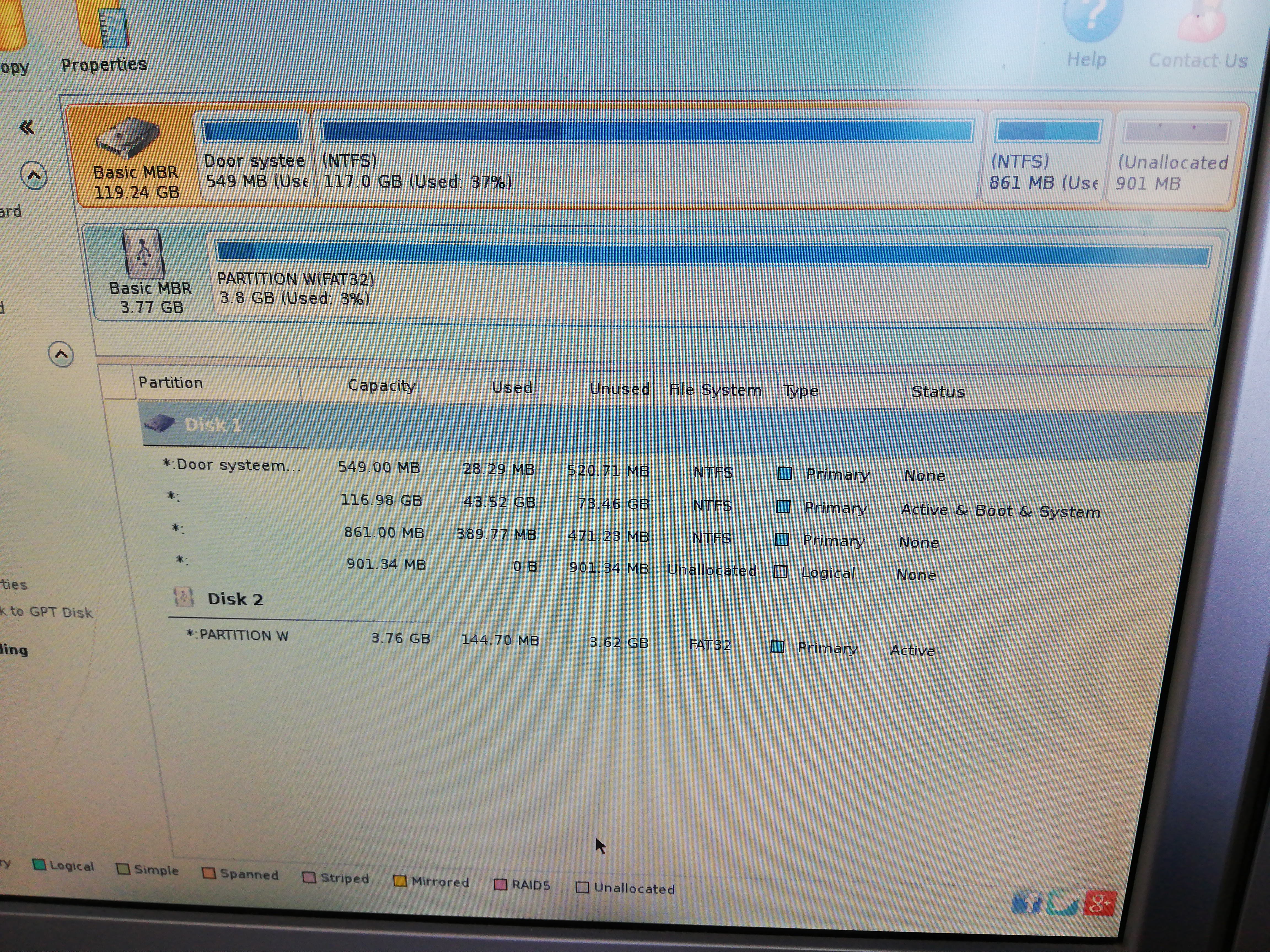

    Partitions on SSD (disk 1) (out of the picture in the legenda it says GPT/Primary as blue. So I think the first 3 partitions are GPT. The disk itself is Basic MBR:

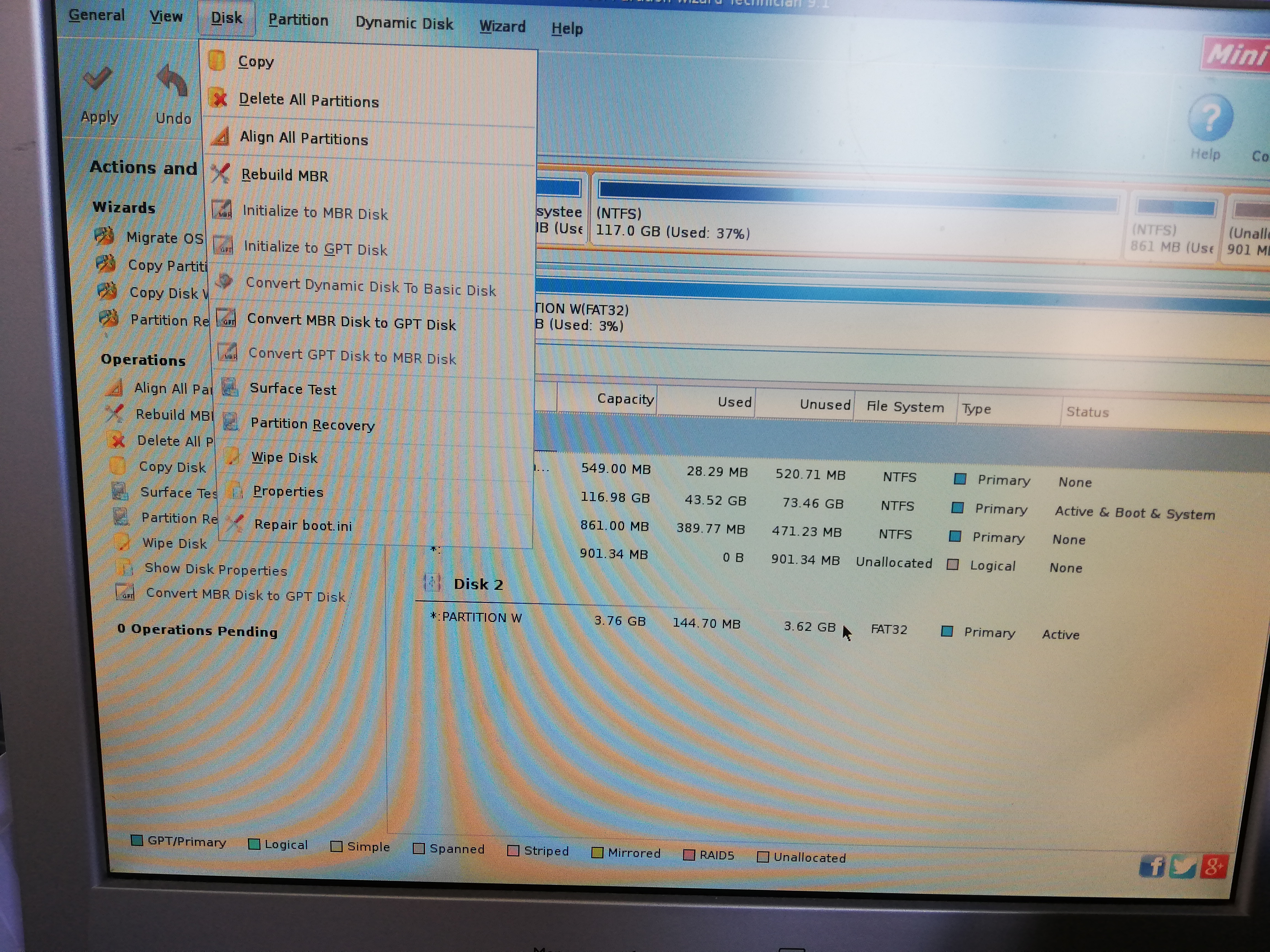

    I even see Rebuild MBR and repair boot.ini?

    2018-08-25T14:18:06+00:00
    Your machine is definitely not UEFI... It clearly states that the drive is "Basic\MBR"... It is already set to "Active" and identified as Boot...

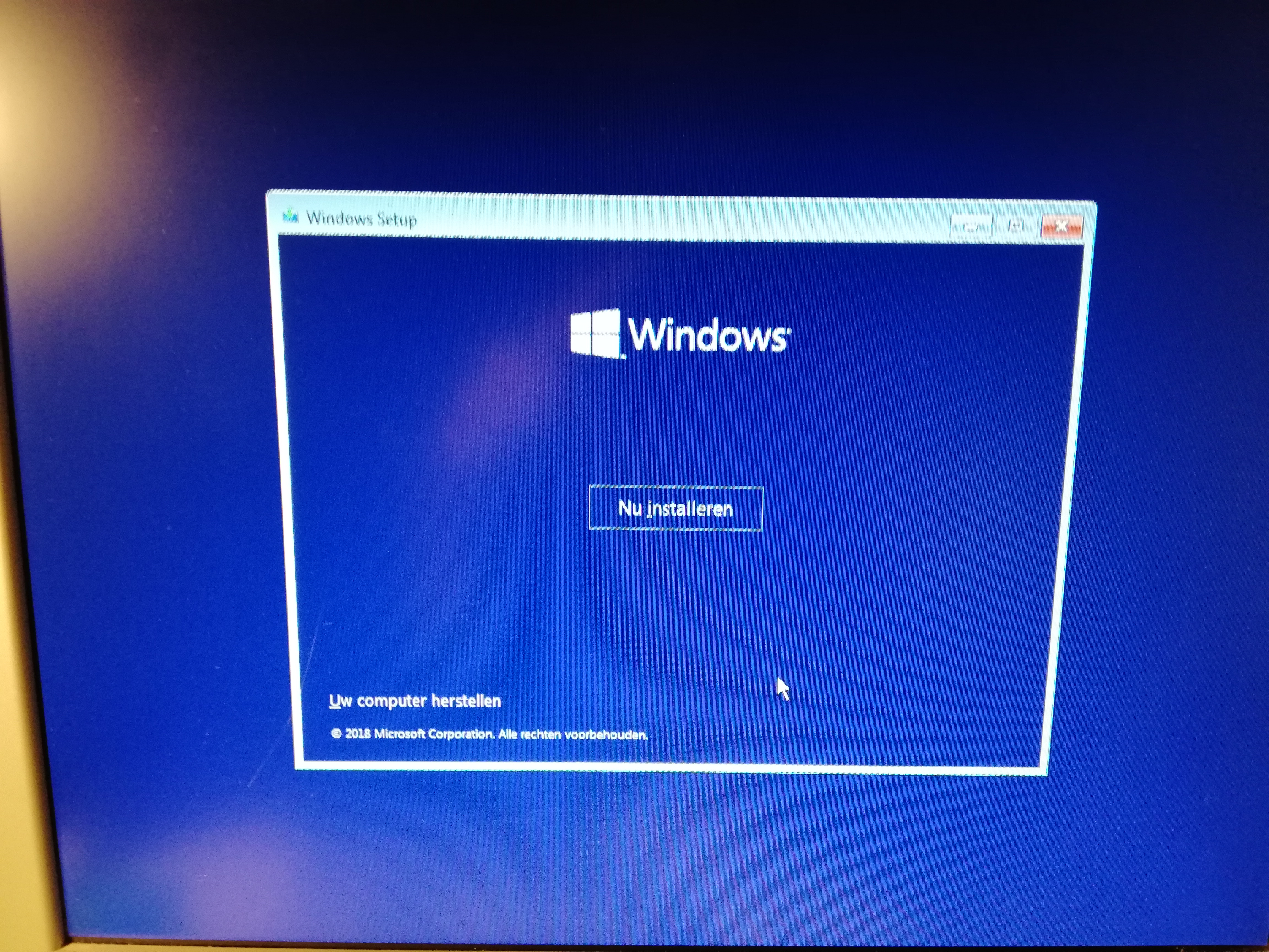

    The thing to do now is to create a installation Flash Drive specifically for Legacy Bios... This picture is for Win 7, but the settings are what you want... Just the ISO name is different...
    Then just boot with the flash drive normally... Don't bother to mess with the boot options stuff... It should be recognized properly...

    Don't mess with the Fix MBR and Boot.ini stuff... Windows 10 does not use the Boot.ini... That is leftover from XP...
    Messing with the Rebuild MBR is dangerous... One little mistake and you are out of luck...

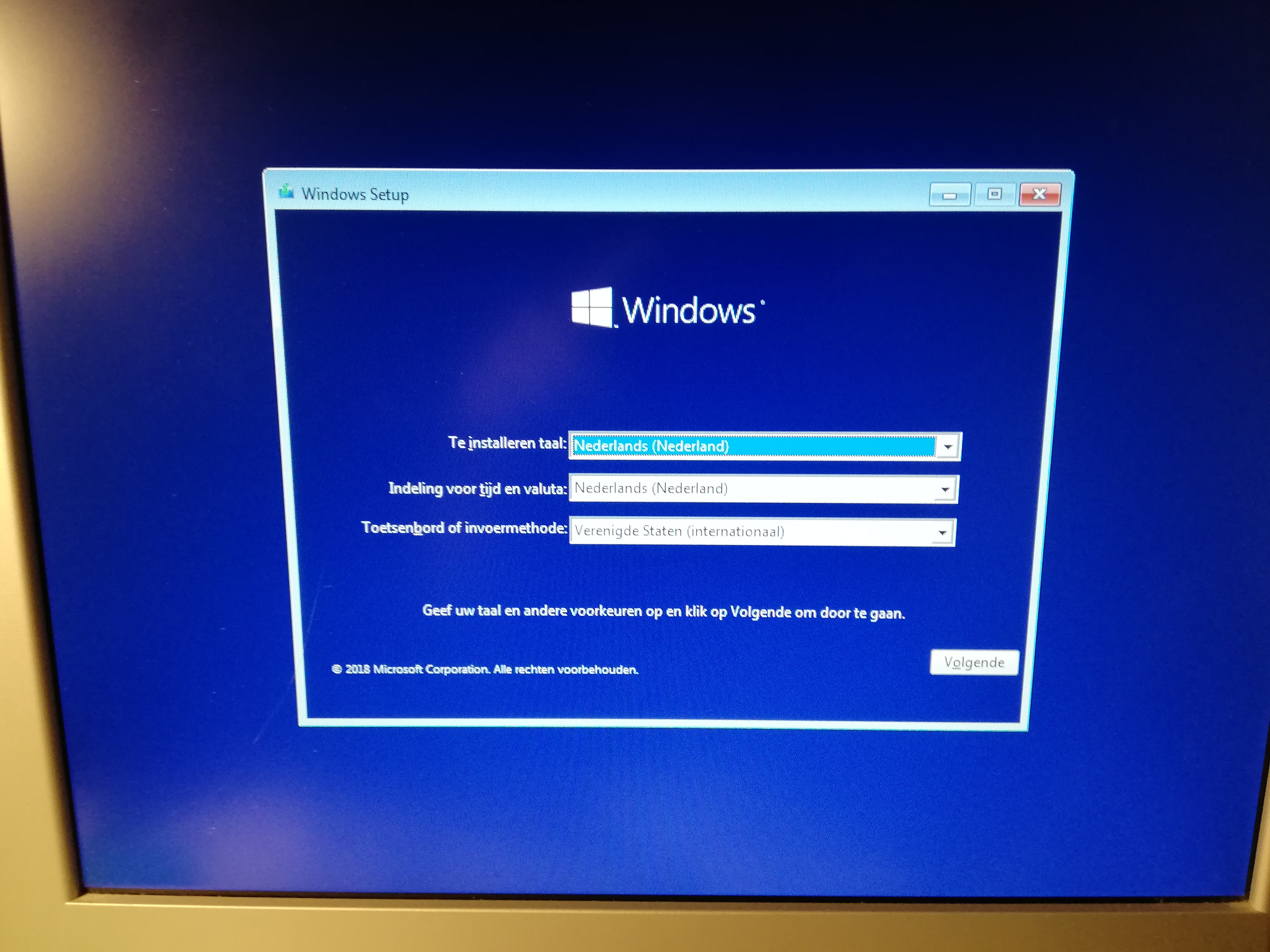

    2018-08-25T15:09:23+00:00
    Thanks again for your help.
    I hope we are a step further now!

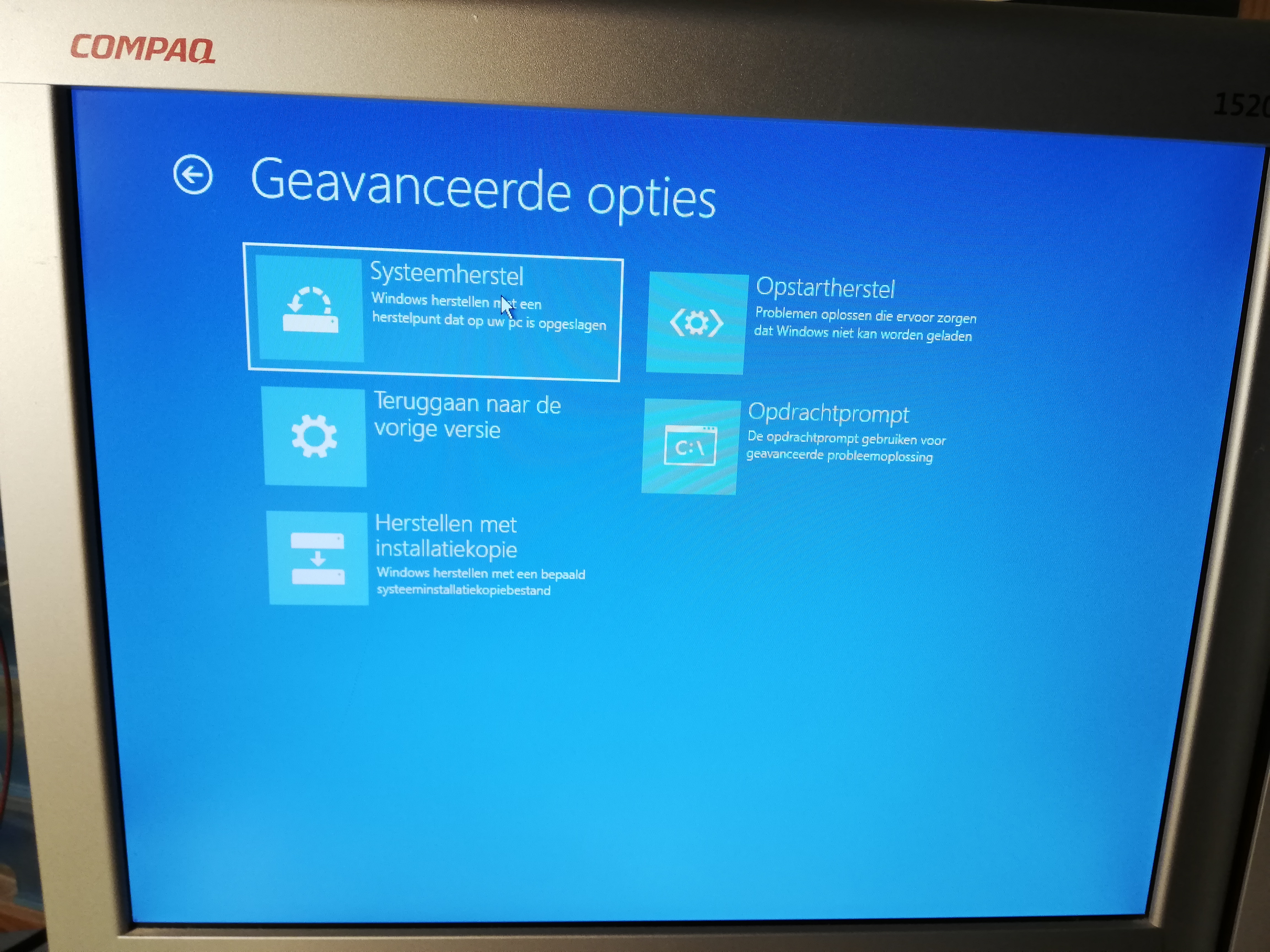

    After booting the drive I first tried startup repair, not working.
    FIXMBR does work (as allways), FIXBOOT not, REBUILDBCD did work.
    After that I runned startup repair again, not working but created a logfile.
    I openend the logfile from the SSD using Lubuntu. It gives C:\Windows as Windows-map and runned tests:
    • Looking for updates errorcode 0x0
    • Test of systemdrive errorcode 0x0
    • Diagnose of write-error errorcode 0x0
    • Test metadata of drive errorcode 0x32
