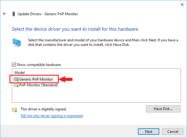

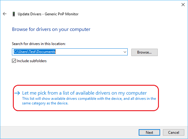

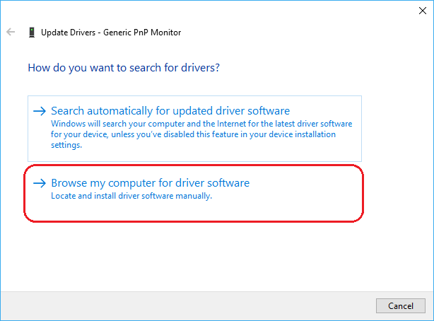

    So far this is what worked for me:
    1. Go to Device Manager
    2. Expand Monitors
    3. Right click on your monitor and select Update Driver
    4. Select Browse my computer for driver software
    5. Select Let me pick from a list of available drivers on my computer
    6. Select Generic PnP Monitor, click next and finish.
