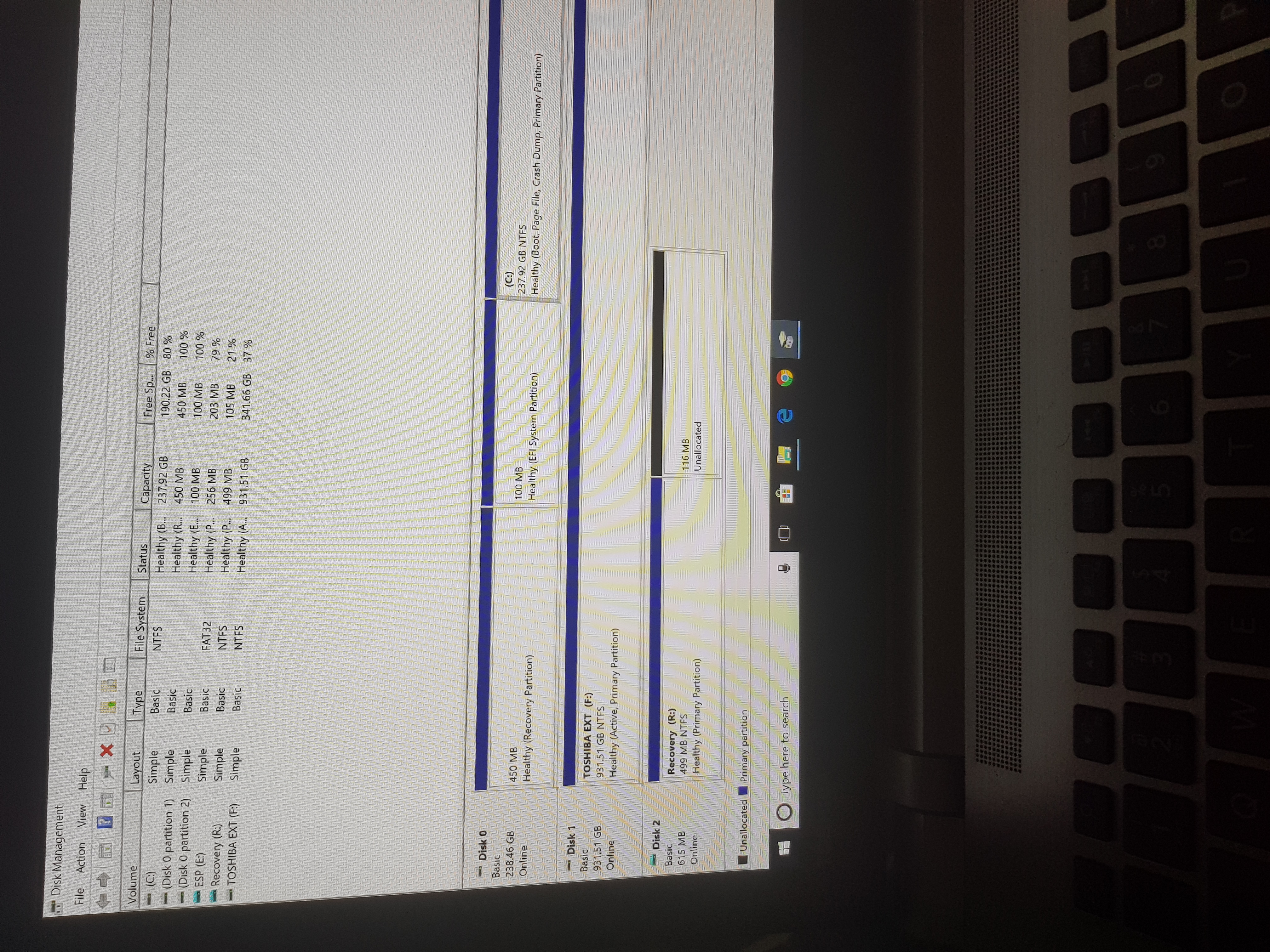

    I see from your picture that the current Recovery partition on disk 0 is 450MB, while the size of the recovery partition on the VHDX file is 499MB.
    You will have to see if the data from the old recovery partition will fit on the smaller current partition.
    Maybe you can check the actual occupied and free space on both.
