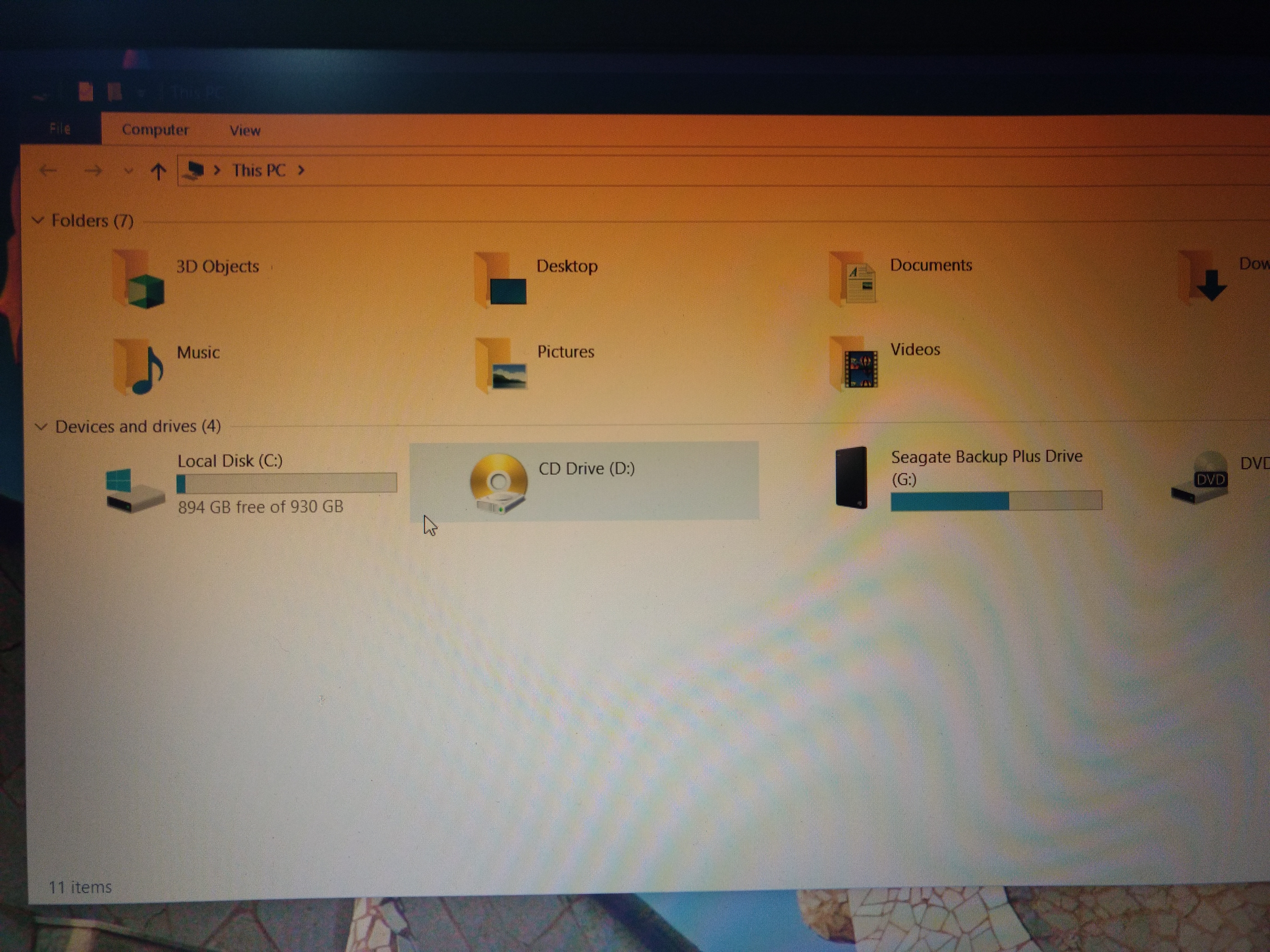

    Hey, so did you manage to restore the partations other than C? Like me, i am trying to restore recovery and maybe efi partation from SIB because whenever i try to reset window, it gives me error. So i think to reset window, you also need to recovery partation from old SIB. So did you manage to do that?
    2018-02-18T08:03:44+00:00
    Not sure what you mean with reset windows ?
    If you did a fresh install of windows before restoring the image of drive C, that creates the EFI and the recovery partition.
    Unless you are trying to reset to the factory setting, in that case you would need the original recovery and or OEM partition that was set up by the manufacturer,  you should have created the recovery media as suggested by the manufacturer when you first received the computer.
    Perhaps you can use Disk Management to attach the VHDX of the other volumes that were created by the backup.
    2018-02-18T08:15:54+00:00
    By reset window i mean resetting the window to factory settings. And yes, i did a fresh install of windows before making SIB and it consists of 3 partations C, recovery & efi. But i am coming to windows laptop after a long time and wasn't aware that i will face the sib restore problem in windows 10, thats why  i didnt care to make a recovery media for my laptop. So only i have restored my c partation using rwb1012 method, is there a way to restore recovery partation as well so i can freshly install a out of box window copy of my laptop?
