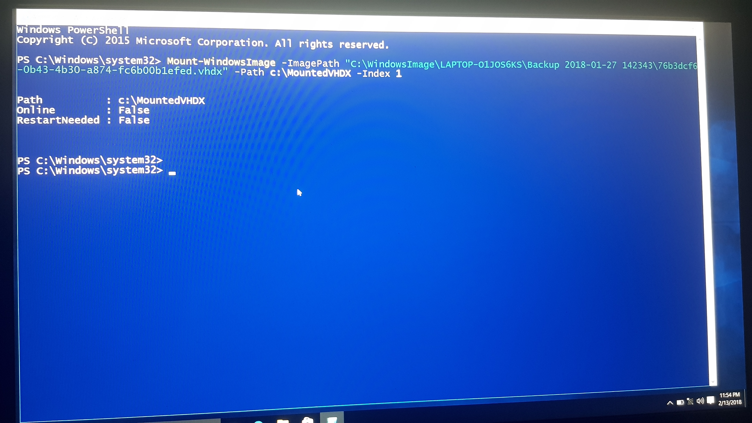

Because you have to wait for quite a sometime after executing the first and second powershell command. Its copying the sib to the external harddrive (sib.wim). And why are you trying to save sib.wim on c drive? It doesn't work that way. It has to be saved on an external hdd.

2018-02-15T05:38:14+00:00 Well maybe I'll just wait over night and see what I have in the morning. It is pointed to a usb drive. I tried the c drive simply to see if the same thing occurred. It looks like the process is working based on the hard drive I/O where the image is stored at. It would be nice if PowerShell could give some sort of output that it is working, without having to look at task manager. Anyways, thanks for the tip wait longer.
2018-02-15T05:56:51+00:00 Even it got me same as you for first 2 or 3 tries. You can do one thing to see if its copying the sib.wim to external hdd or not. After executing 1st and 2nd command wait for few minutes and then copy and paste the 3rd command (thats what i did for all) if that command it not executing it means copying is going on at the background. At first it wasn't sure why the 3rd command is not executing ( newbie ) so i copy pasted it 4 or 5 times and i think at one point poweshell got tired of me ...lol and then suddenly operation is on going came up on it. Then i know itc copying the files and you can then also open you wim folder in external hdd and check in its properties that size of it is increasing.
2018-02-15T06:42:09+00:00 Well maybe I'll just wait over night and see what I have in the morning. It is pointed to a usb drive. I tried the c drive simply to see if the same thing occurred. It looks like the process is working based on the hard drive I/O where the image is stored at. It would be nice if PowerShell could give some sort of output that it is working, without having to look at task manager. Anyways, thanks for the tip wait longer.
From what I remember when I tried rwb1012 procedure there was a progress line showing on the green portion of the screen...
2018-02-15T06:49:54+00:00 It did for me after someone. Did you try to reset your window after trying rwb1012 method? Because whenever i try to do that i get error that window cannot be reset. I think it may be because we only restored the c partation of sib using that method and not the recovery and efi partation from the previous SIB. So if there's a workaround this please let me know. Thanks
