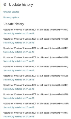

Windows Update downloads and attempts to update KB4033631 and KB4049411 on Windows 10 64 bit laptop daily and it fails each time with:
There were problems installing some updates, but we'll try again later. If you keep seeing this and want to search the web or contact support for information, this may help:
  • Update for Windows 10 Version 1607 for x64-based Systems (KB4033631) - Error 0x8000ffff
  • Update for Windows 10 Version 1607 for x64-based Systems (KB4049411) - Error 0x8000ffff

    I have been experiencing the same issue on my Dell XPS 15 laptop. 3 separate MS technicians connected remotely to my laptop to try to fix the issue but the same steps were followed in all of the cases:
    -clearing the Temp folders
    -running the Windows Update troubleshooter
    -stopping services and startup programs
    Nothing fixes the issue. KB4033631 and KB4049411 keep installing "successfully" non-stop. Windows 10 update to 1709 also keeps trying to install non-stop but fails with code 8007001f. I tried running disk clean which at one point had 21.5GB of files to delete because of all the failed Windows 10 updates.
    I tried updating Windows 10 to 1709 via the Windows 10 Update Assistant, and also via the MediaCreationTool. Neither of them work. This morning the standard Windows 10 Update (via Check for Updates) showed that an update to 1709 was available. It ran the update and after rebooting I got a notification that Windows could not install all updates. Of course the update to 1709 failed but the 2 KBs above "successully" installed again for the 100th time.
