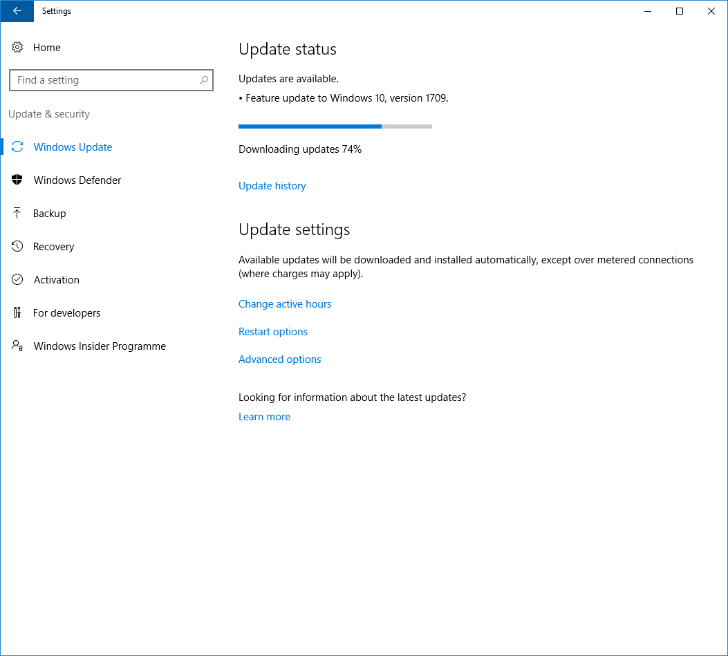

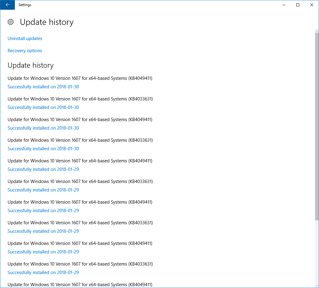

    I have had this problem for at least a month now. I have tried to run the update diagnostics tool, downloaded the manual update application, disabled the update service and removed the SoftwareDistribution folder from C:\Windows and tried to download it again... nothing helps.
    Every day Windows downloads the update and tries to install it and fails and then the process gets repeated. I must have downloaded hundreds of gigabytes for just this update.

    This problem seems to have started 13-12-17 when the updates you refer to were sent out . Many thousands of others have reported this to Nicrosoft and no solution has come from them.
