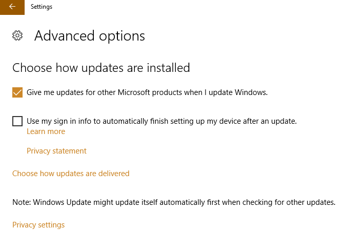

    It was present in one of the checkboxes in your screen shot.
    I checked it, but after the successful update from 1607 to 1703 (Win10 Pro) the deferred option changed as mentioned in my post.
    I am not sure about windows update assistant. What I did was to click on check for updates once I uninstall that assistant from Apps, and it started downloading update for 1703.
    So to resume:
    1. Checked the checkbox deferred update
    2. Uninstall assistant from Apps
    3. Run windows update

    2018-01-10T20:05:35+00:00
    What were your exact steps to defer the upgrade to 1709 and install 1703 first? I went into the advanced options of Windows Update and did check the "Defer" option. I then uninstalled the Windows 10 Update Assistant. However soon after another "Windows 10 Update Assistant" appeared and tried installing 1709 (which failed again as usual). I checked and now I no longer have any option for deferring upgrades or re-enabling it. I uninstalled Windows 10 updateassistant AGAIN and shortly after (a couple of ours or the next morning), my laptop was trying to install the Windows 10 update. Was there another step to ensure that Windows doesn't keep installing the Windows 10 Update Assistant?
    Thanks!

    2018-01-10T19:22:44+00:00
    With your method I was able to finally jump from 1607 to 1703. However I do not see the deferred update option in windows update advance option anymore.
    What I have instead is a drop down option saying:
    "A feature update includes new capabilities and improvements. It can be deferred for this many days:"
    With values ranging from 0 - 8. 0 being the default selected option.
    Now I'll be waiting to see if this update can get me up to 1709.
    But A BIG THANK YOU already as I was struggling to get pass 1607.
    *EDIT* the deferred option is now classified as "Branch" in advance option. Choosing current branch found the 1709 update. While the "Current Branch for Business" didn't. Downloading as I am typing.
