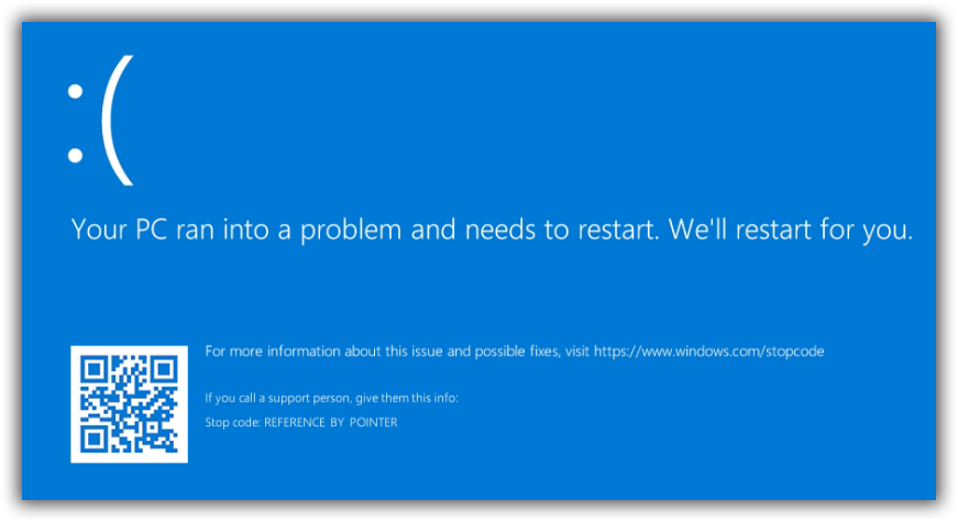

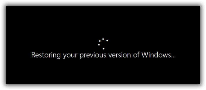

    Okay, that was good timing - I just so happened to be working on my 2nd screen with the VM running on the other screen with video recording going. There was a blue screen at about 15% of the update. It then restarted but as I type this is blue screened again (I'm not worried, I have a snapshot of the VM before update). Okay restarted again after blue screen - now it's "Attempting to restore your previous version of Windows"...
    2017-11-08T19:11:37+00:00
    Couple of screenshots grabbed from the video: two bluescreens with same information:
    And then it restored the original operating system:
