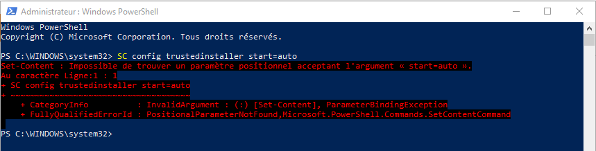

    Bonjour,
    Are you sure to use cmd command ??
    I supose you use power shell command; please check this point and if it is the case it will be neccessaray to perform the explanation given by Paul:
    Regards
    If you are currently experiencing the 0x80070bc2 error while attempting to install KB4074588, please try this:
    1. In the search box on the taskbar, type cmd.
    2. Right-click Command Prompt in the search results and select Run as administrator.  (Select Yes, when prompted by the User Account Control.)
    3. In the Administrator: Command Prompt window, type the following command and press Enter:
    SC config trustedinstaller start=auto 4. Restart the PC.
    In some cases, a second restart may be required. If you look under Settings > Update & security and you see the message Status: Awaiting restart, restart the PC a second time to complete the installation.
    Paul...
