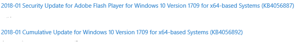

    These are the two updates I attempted to install  that were listed after a "Check for updates", which one failed I don't know:
    2018-01-09T19:12:43+00:00
    Update:
    New Intel CPU did all the updates after using the QualityCompat fix. Unfortunately, on the last reboot, CPU went DOA due to mechanical failure.
    Old AMD, fix still did not take it past KB4051963.
    KB4054517 says it's not for this computer. KB 4056892 ended after updating with a small, blue window in the middle of the screen. Restored to the KB4051963, and applied the Windows update fix that lists what the updates are for you to choose.
