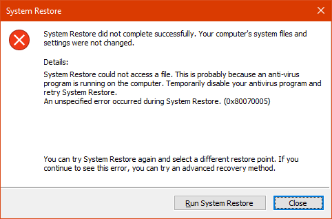

I think I'v installed the Spotify app from the Microsoft store three times over the last months, and every time I get the same effect: system restores are no longer possible:
So that's a reason for me not to use the app anymore, although for the rest, it works as a charm!
Anyone any idea why the Spotify app and System Restore are incompatible?

    My HP Envy worked fine when I went to sleep. When I woke up, the touch screen and USB mouse/keyboard all stopped working in Windows (touchscreen still worked fine in diagnostic tests). I investigated and found the drivers all appeared to be missing. I tried updating them or reinstalling them and restarting with no luck. Then I decided it was time to try a system restore...Blammo, now I can't get out of the boot error loop or restore the system to any working point. The same 'Spotify.exe' file is identified as the conflict that prevents the system restore from completing.
    I can get into command line from the startup diagnostic screens but when I try to do anything to that Spotify.exe file it says the system cannot access the file (probably what's preventing the restore from working in the first place). Is there a way to change the permissions on this? Would that allow system restore to overwrite it?
    I have also been unable to access safe mode. But, I can see that all of my files are still intact, and I can transfer them onto an external hard drive...but I'd really not like to have to buy a new computer because of this one spotify file seems to be preventing a system restore...
    Any help resolving this would be greatly appreciated.

    nobody has been able to "fix" this issue and I recently experienced it with an HP Envy 17' laptop that  once overnight after a windows 10 update I lost drivers on all my usb ports and then a month later after a windows 10 update I lost external usb port mice drivers but the usb ports themselves appeared to be working.  Then I got stuck in the spotify screws up a system restore loop.
    I was able to get the system operating again by doing a windows reset (not full factory reset) that kept my data and re-installed windows cleanly eliminating all the programs I had installed (but could install again).  You can get to that option from the advanced startup options.
    I will not install the spotify app on this laptop anymore and if I want to use spotify I will use the browser application.  And if I do need to install it I will do it from the spotify site on my browser not from the Windows 10 apps site.  I think the version on the Windows 10 app site maybe causing the problem since I have multiple computers here and none but the recently restored laptop used the Windows 10 app version.
    One thing i noticed with the last spotify install that caused this problem.  I could not get it to stop starting up when i start up the laptop.  there is a spotify problem topic on this issue.  I think that was a "tell" about spotify interfering with windows at startup.   If I ever saw that problem occur I would solve it first before attempting to use "system restore" on windows.
