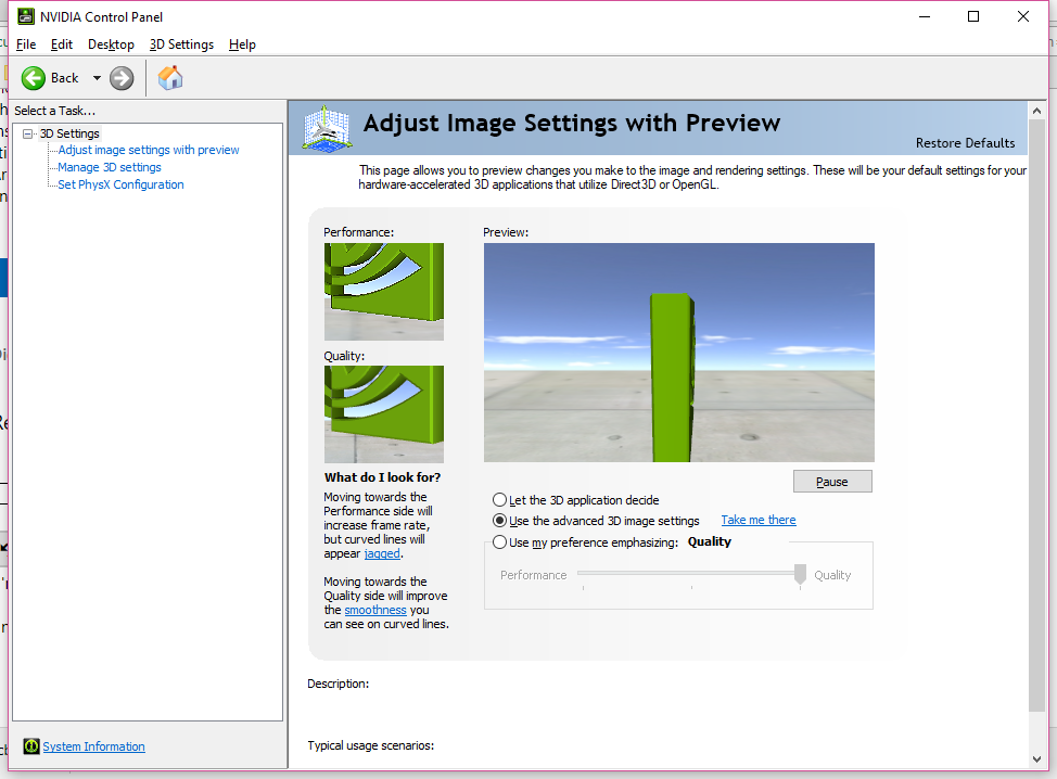

    Lets try this first, under power settings, pcie, set to moderet power savings.
    In nvidia control panel, set to variable power settings, this will let the gpu draw
    more power when needed and less with less demanding things.

    In Nvidia control panel there are no options for power. Only for 3D settings.

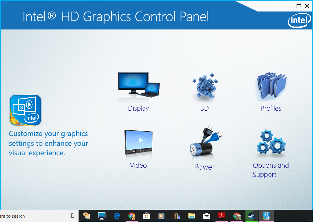

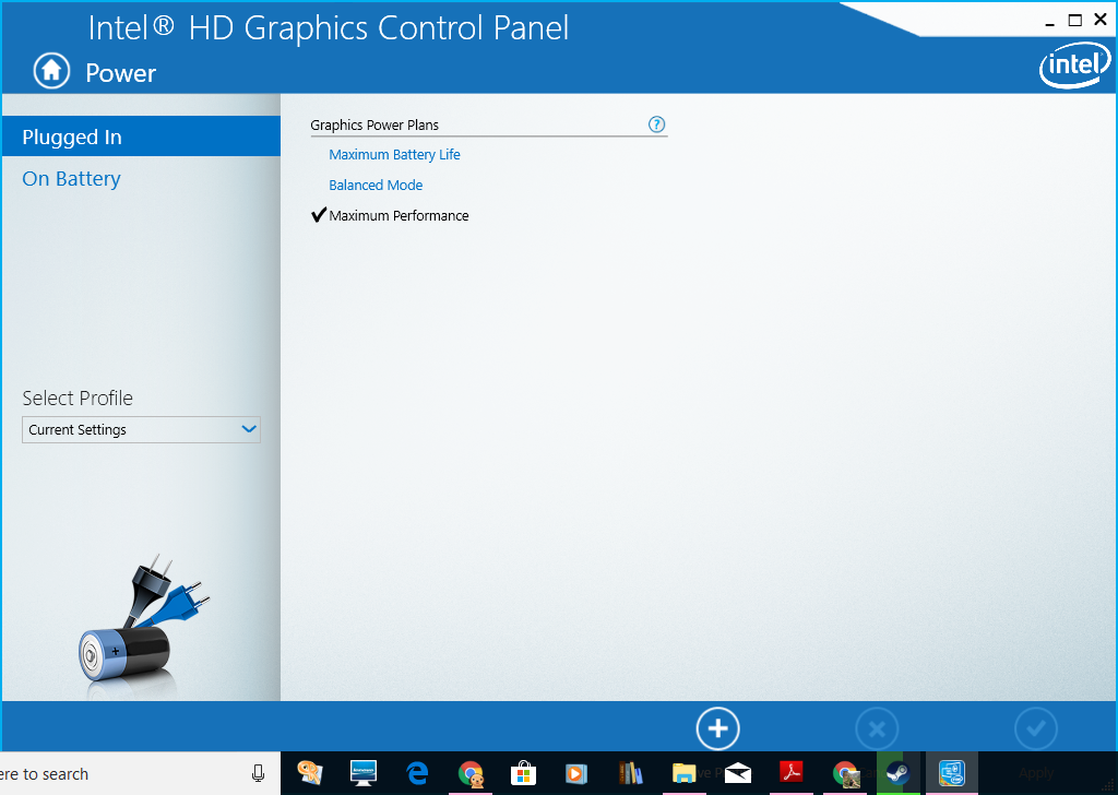

    From HD Graphics Control Panel, there is an option for power but can only select between
    Maximum Battery, Maximum Performance, or Balanced Mode
