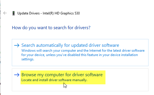

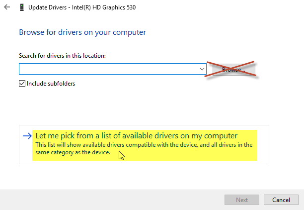

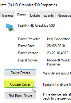

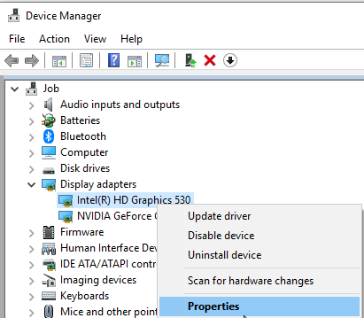

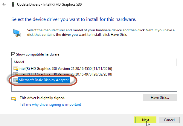

    2019-01-08T13:02:52+00:00
    After spending a lot of hours looking into this issue, I found a easier, and quicker solution:
    Go to:
    • Device Manager
    • Display Adapters
    • Open properties of Driver
    • Select Tab Driver
    • Select button 'Update Driver'
    • Select option 'Browse my computer for driver software'
    • Choose option Let me pick from a list of available drivers on my computer
     Don't use the Browse button (Microsoft Basic Display Adapter is an already available driver)
    • Select 'Microsoft Basic Display Adapter'
    So, that's all folks... I hope this will help a lot of people struggling with the issue
