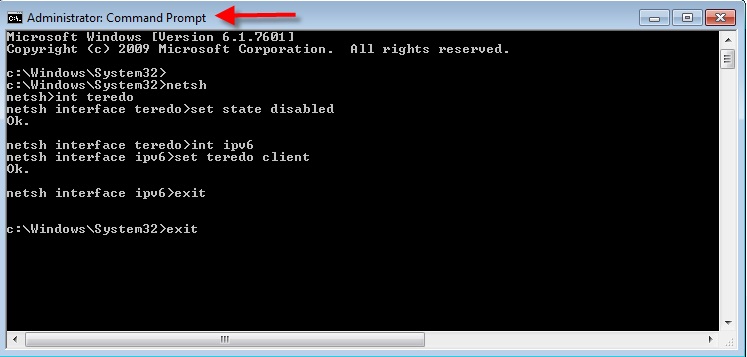

    Here is a generic procedure for you to follow:
    Click the Start orb/button and in the box enter the following:
    cmd.exe
    Right click cmd.exe and choose to Run as Administrator:
    ![](https://learn-attachment.microsoft.com/api/attachments/cecbb081-c66d-4087-9fb1-b07f3e132392?platform=QnA)
    In the Command Prompt window enter the following commands one at a time pressing the Enter key after each:
    • netsh
    • int  teredo
    • set  state  disabled
    • int  ipv6
    • set  teredo  client
    • exit
    You should be seeing something like this as you enter the commands one at a time:
    Close the Command Prompt window by entering exit one more time.
    Restart your system and see how things look in Device Manager now.
