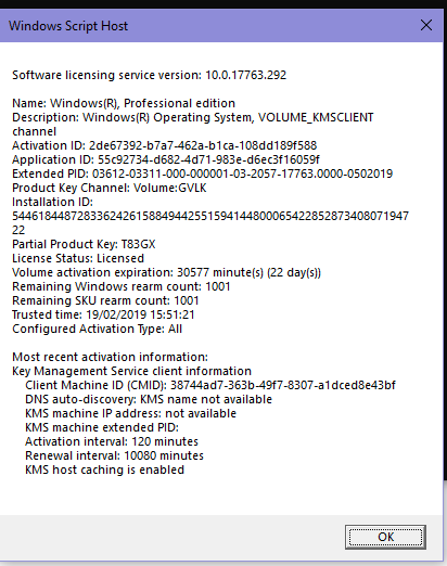

    Hi Andre, I am at a loss as to how to stop the "your licence expires soon, please go to settings to activate your account". This Laptop is not great, so after buying a desktop PC I decided to reset it, removing everything so I could just put some music production software on it for college. Everything seemed okay until this message kept on appearing. I purchased the laptop off a friend, she gave me the receipt and Windows 10 was already installed. On the box it says Windows 10 Home and I am pretty sure that it was Home before the re installation. Now it says Windows 10 Pro, I have not upgraded, it says that activation is through my organisation's activation service. This is a personal computer, I have no organisation.
    I have tried just about every fix from Microsoft to You Tube, even forums, all claiming to solve the problem but it doesn't. I attach the screen shot you requested from a previous client.
    I hope you can help. Email : ******@gmail.com Thanks, Nick
    2019-02-19T16:26:43+00:00
    Your computer has a volume license.
    "Description: Windows Operating System, VOLUME_KMSCLIENT channel"
    That type of license is sold to organizations that buy Windows licenses in bulk. In order to maintain its activation, a computer with that type of license has to be in regular communication with the organization's activation server.
    If your computer belongs to an organization, contact the organization's network administrator to determine why the computer is not contacting the organization's activation server.
    If you are an individual user you need to purchase a retail license for Windows 10 Home or Windows 10 Professional and do a clean install.

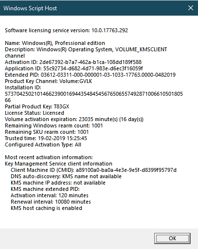

    2019-02-20T10:41:15+00:00
    Hi jayd8,
    from the screenshot you provided it appears that Windows is activated properly.
    Could you share what the warning looks like?
    Also, please try the following:
    a: Press Windows key + X.
    b: Then click Command Prompt(admin)
    c: Now type the following command and then hit enter
    slmgr -rearm
    d: Now restart the computer.
    This will send an Windows activation request to Microsoft's activation servers and should fix the mismatch.
