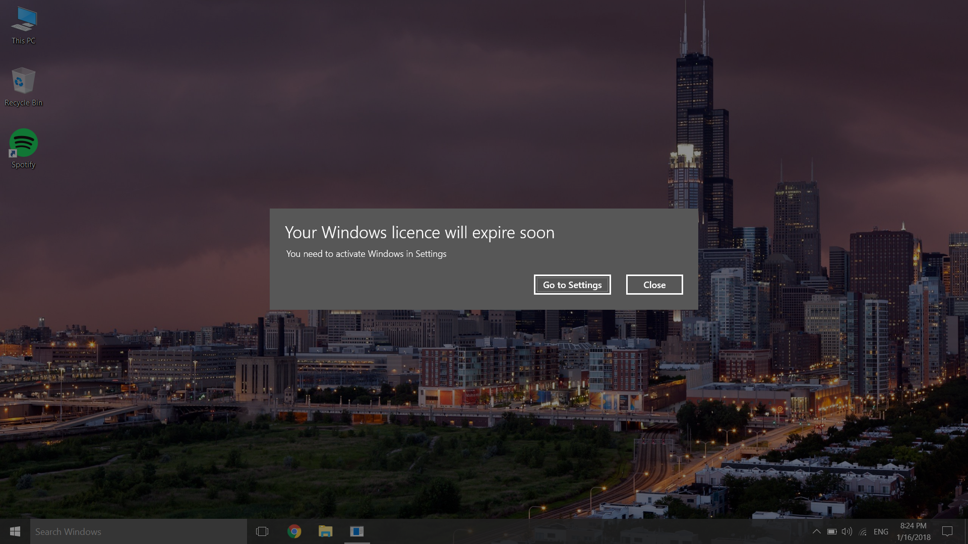

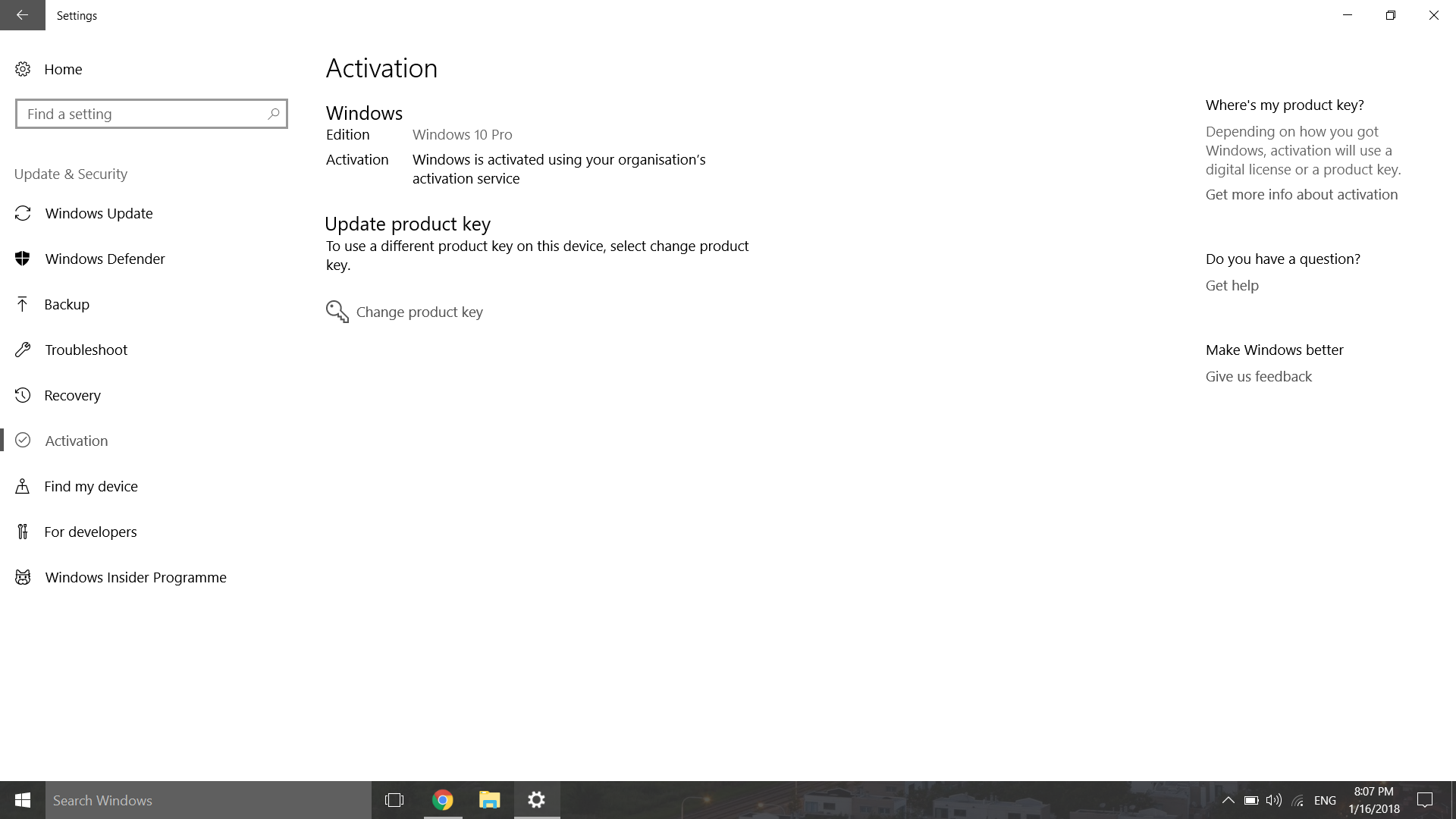

I'm currently using 'Windows 10 Pro' and my windows has been activated by my organisation's activation service. But i kept getting notification that my windows license will expire soon, it started happening after windows update.
I've tried using slmgr /upk and logging out of my microsoft account but none of that seems to work, I suspect that this is caused by the windows update because before the update I never get this notification.

    2018-01-16T13:17:19+00:00
    Hi jayd8,
    from the screenshot you provided it appears that Windows is activated properly.
    Could you share what the warning looks like?
    Also, please try the following:
    a: Press Windows key + X.
    b: Then click Command Prompt(admin)
    c: Now type the following command and then hit enter
    slmgr -rearm
    d: Now restart the computer.
    This will send an Windows activation request to Microsoft's activation servers and should fix the mismatch.
    Best regards,
    Ralitsa

    I've tried, but it's not working
    whenever I go to settings, it doesn't have an option to activate windows
