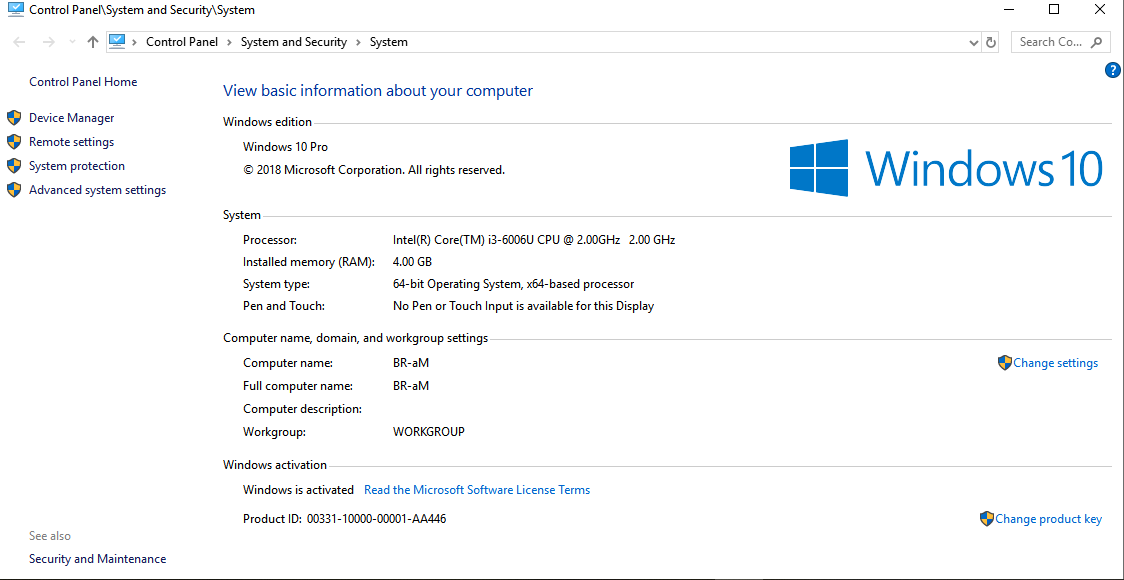

    2019-02-20T10:41:15+00:00
    Hi jayd8,
    from the screenshot you provided it appears that Windows is activated properly.
    Could you share what the warning looks like?
    Also, please try the following:
    a: Press Windows key + X.
    b: Then click Command Prompt(admin)
    c: Now type the following command and then hit enter
    slmgr -rearm
    d: Now restart the computer.
    This will send an Windows activation request to Microsoft's activation servers and should fix the mismatch.
    Best regards,
    Ralitsa

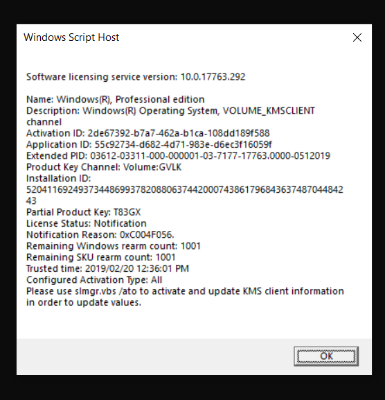

    2019-02-19T16:26:43+00:00
    Your computer has a volume license.
    "Description: Windows Operating System, VOLUME_KMSCLIENT channel"
    That type of license is sold to organizations that buy Windows licenses in bulk. In order to maintain its activation, a computer with that type of license has to be in regular communication with the organization's activation server.
    If your computer belongs to an organization, contact the organization's network administrator to determine why the computer is not contacting the organization's activation server.
    If you are an individual user you need to purchase a retail license for Windows 10 Home or Windows 10 Professional and do a clean install.
