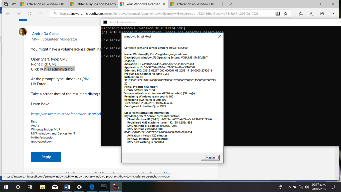

    You might have a volume license client installed. To confirm:
    Open Start, type: CMD
    Right click CMD
    Click Run as administrator
    At the prompt, type: slmgr.vbs /dlv
    Hit Enter
    Take a screenshot of the resulting dialog then post in a reply here.
    Learn how:
    https://answers.microsoft.com/en-us/windows/wik...

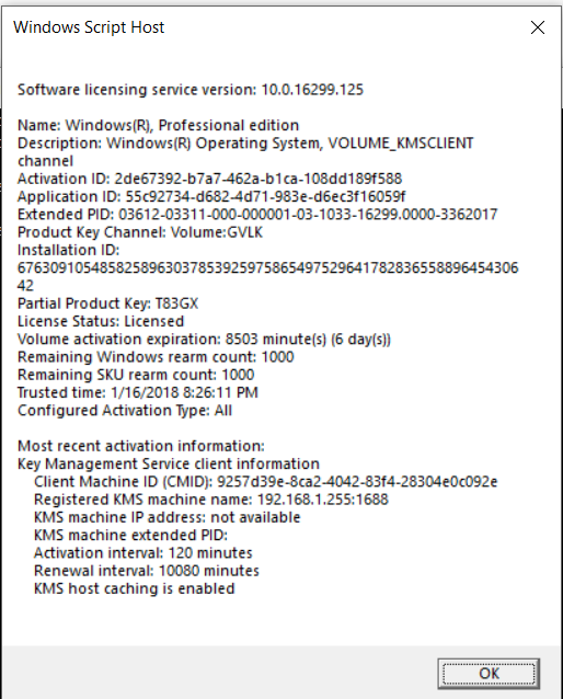

    2019-03-02T13:17:41+00:00
    This the window that opened with the command
    Right click CMD
    Hit Enter
    Learn how:
