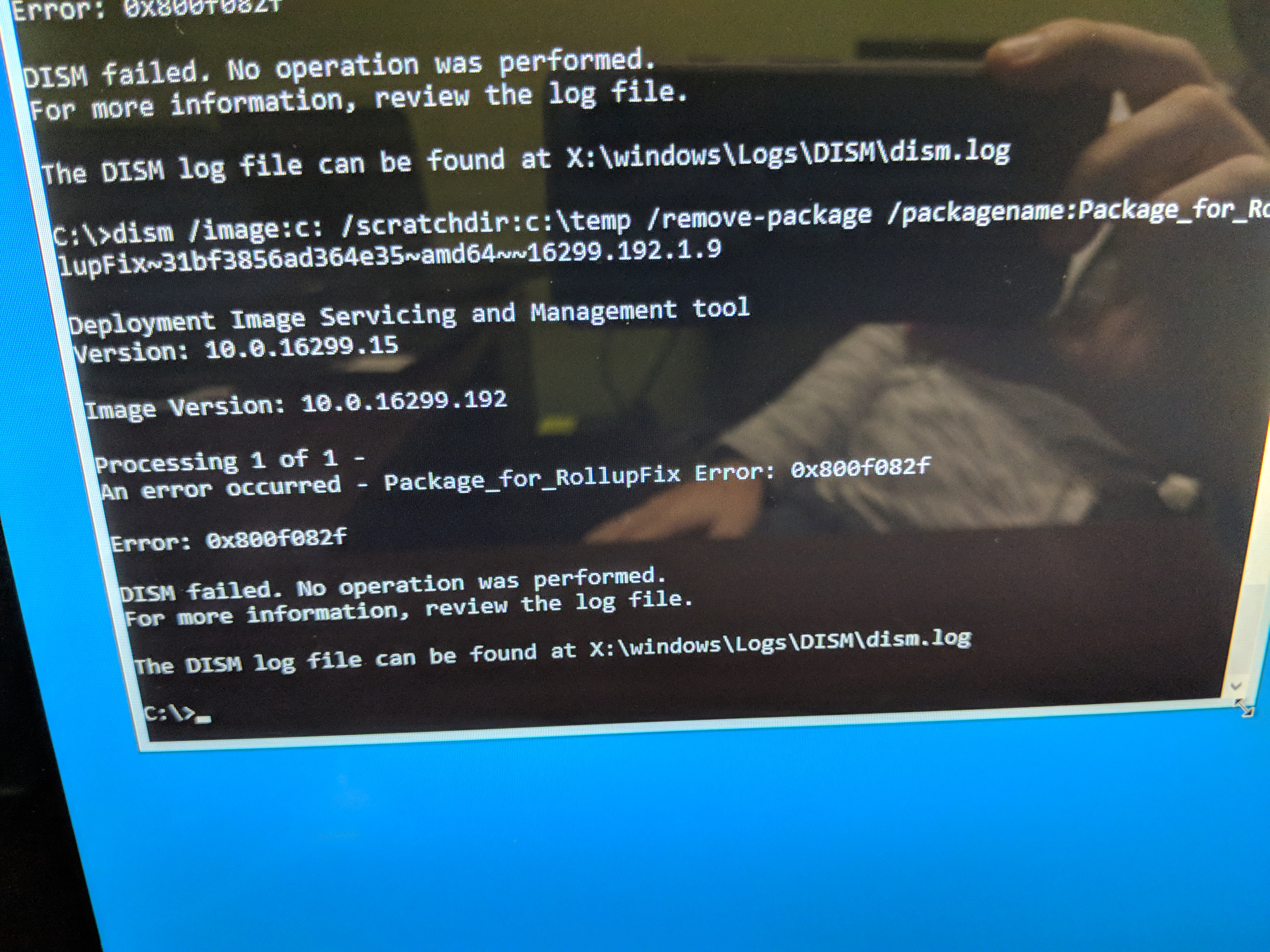

    Here is the screenshot
    2018-02-23T18:18:15+00:00
    Follow the kb posted and dont use the scratchdir commands
    2018-02-23T18:27:26+00:00
    It gives the same error message.
