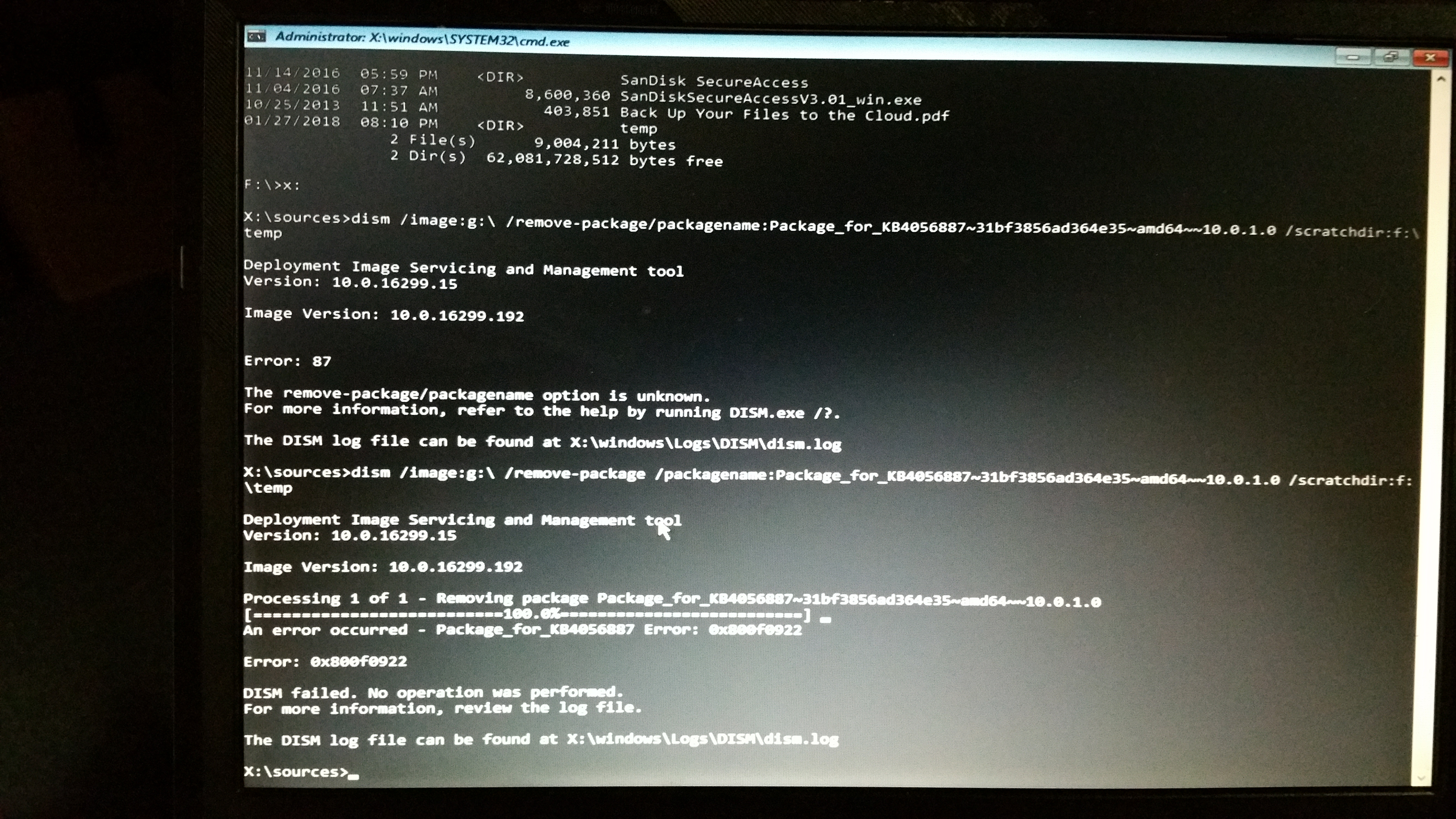

    Thank you for your fix.......... but let me tell you how that worked with my notebook from Lenovo with Intel Chip!
    Had the "inaccessible bootdrive" problem after the patch : KB4056892
    Did try a lot of things that did not work, found your fix, tried it, but got allways this error:  DISM 0x800f082f
    I did try again a lot of things but could not remove the package.
    After a long time searching I found this webside:
    http://www.varidan.com.au/how-to-fix-the-dreaded-windows-error-0x800f082f/
    with the hint to change this key in the registry
    [HKEY_LOCAL_MACHINE\SOFTWARE\Microsoft\Windows\CurrentVersion\Component Based Servicing\SessionsPending]
    So, after changing the registry key : "Exclusive" from 4 to 0, the uninstall worked and the system is up and running again.
    I did not try any updates yet but will wait some days.
    So, if anybody is having the same error 0x800f082f while trying to revert maybay this helps

    It really didn't have anything to do with Bitlocker since the error reappeared today. I had no luck uninstalling the latest January updates through dism either. Windows did indeed start once, but after the first reboot got the same "inaccessible boot device" message again. Uninstalling even more updates with dism didn't help.
    I once again restored my working backup and toggled the pause update switch. This really is my last option until Microsoft fixes this error. Btw. the working backup is from January 14th (Window 10 build 16299.192) which I find a bit strange since this should include all the latest updates. But still it does work - at least for some time.
    It sure is the most serious and time consuming Win10 bug I have witnessed since Win10 was introduced. It makes me remember all the warning voices from back then, that saw these kind of issues with forced rolling updates coming.
    What is kinda typical though is, that the only machine that's been hit by the bug is a 32bit machine which, for its ancient 16bit monitoring software, really is indispensable for the company.
    PS: My "last option" failed me merely minutes after I posted the above. I again restored my backup and uninstalled the latest three updates through the Control Panel > Programs > Programs and Features > Installed Updates dialog. Windows tells me that it is now build 16299.125. I again toggled the pause update switch and went through a couple of restarts successfully. My issue seems to be mitigated for now - fingers crossed.
