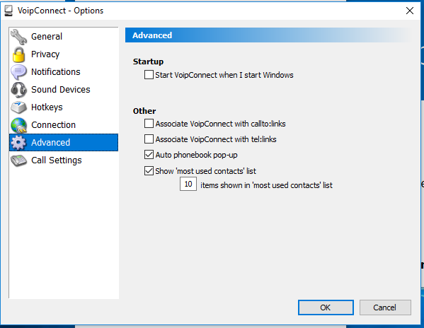

    With VOIP Connect, if you go to Tools > Options > Advanced and UN-check the box that says "Start VOIP Connect when I start windows", that should eliminate the problem the next time the computer is turned on.
    Since I had had VOIP Connect installed on my computer with no problems until a Windows Update came along, I'd say the problem is with Windows 10 update which is misidentifying a process as an app, and preventing a shutdown.
