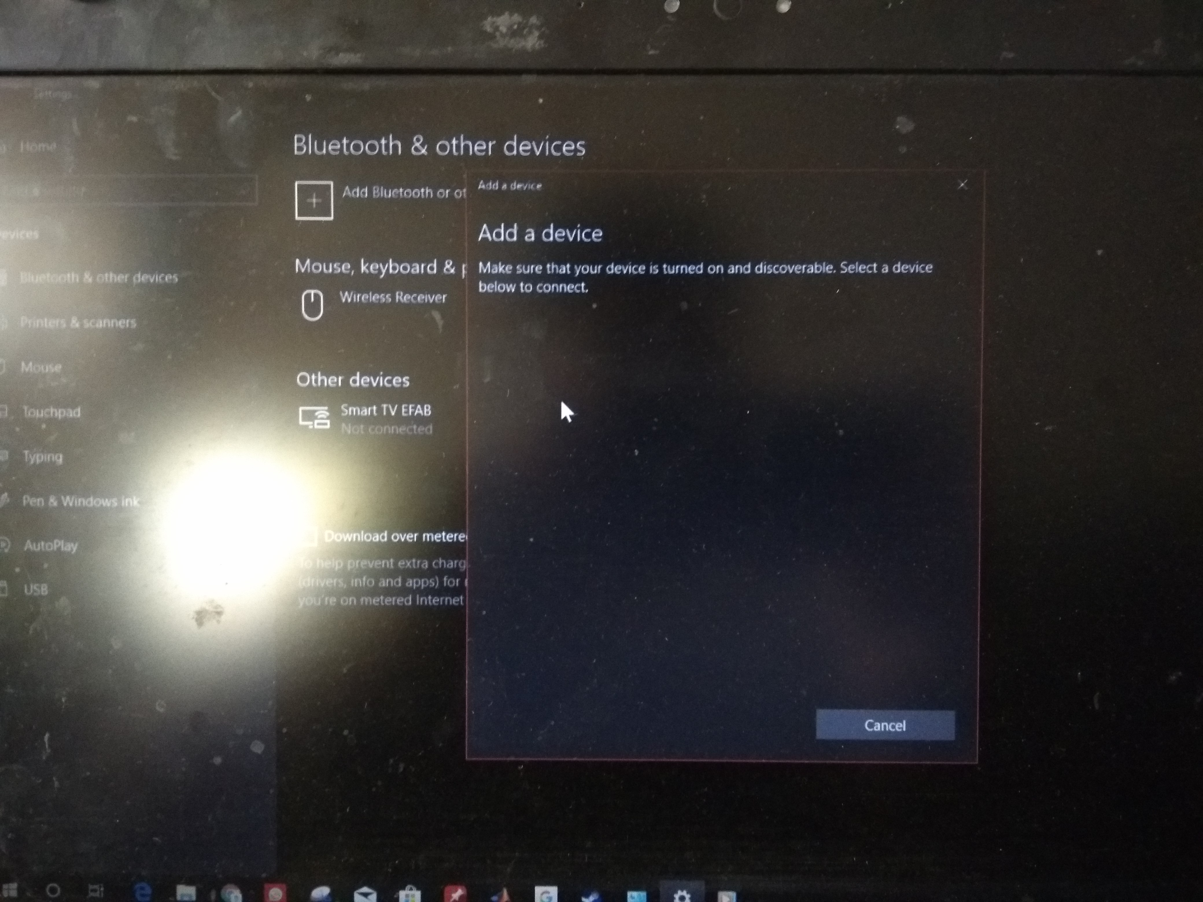

Back to PC -> Settings - Devices - Add Bluetooth and other devices -> wireless display or Dock
Smart TV would appear there and you should be able to connect.
