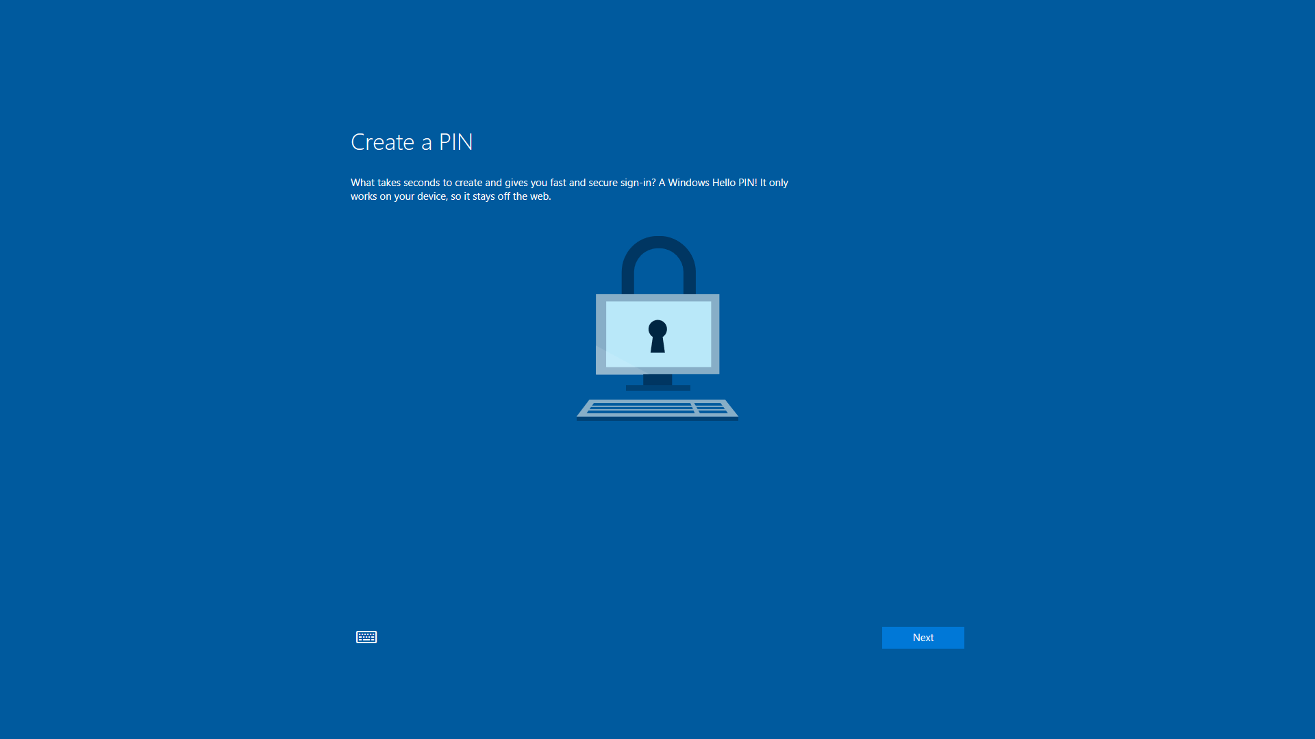

You guys might want to step up your testing efforts. This is a pretty obvious bug IMO. To be clear, I want to use my password and not a pin. But the UI says, "We think you will like it."... well I don't. Normally there is an option to set a pin later.... Well, this goes away permanently if you initially try to authenticate using the Windows Authenticator app.
I am prompted to set a pin, with no button to skip or proceed without one. If I bring up the dialog and cancel, that doesn't help either... You are basically stuck on that screen. I can't finish the installation because the only option to proceed is to create a pin which will replace my password -- I don't want to do that.
So to be clear:
Install Windows 10 and enter your name and password during installation... You can skip setting a pin.
Install Windows 10 and enter your name and then select authenticate with the authenticator... I successfully authenticate and then I am asked to set a pin. The option to skip is not there as in the first scenario. Starting the process over and entering a password instead does not help. It seems the option to skip is never available again. The only thing I could do was to wipe the install and start over.
Sure I could have set a pin and removed it later, but I didn't want to do that. I don't want it messing with my login.

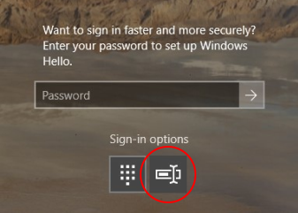

    This is stupid but it seems it has to be done this way:
    1. When Installing Windows, you must setup a PIN, the only way around it is if there is an error, so I just setup a PIN.
    2. After Windows is installed, go into the Settings App->Accounts-> Sign In Options and remove the PIN
    3. After restarting Windows, the password box that shows by default is to setup the PIN again, do NOT type your password into the box, you must first click this icon under "Sign-in Options" (Hopefully it is there for everyone)
    1. Then Type in your password and it should log in without bugging you about setting up a PIN.
    Now you need to check that this "Sign-in Option" is selected every time you type in your password, but it seems that it defaults to your previous selection on subsequent restarts so it hasn't been a problem for me.
    Hopefully this helps for anyone that missed these new "Sign-in Options" buttons like I did.
