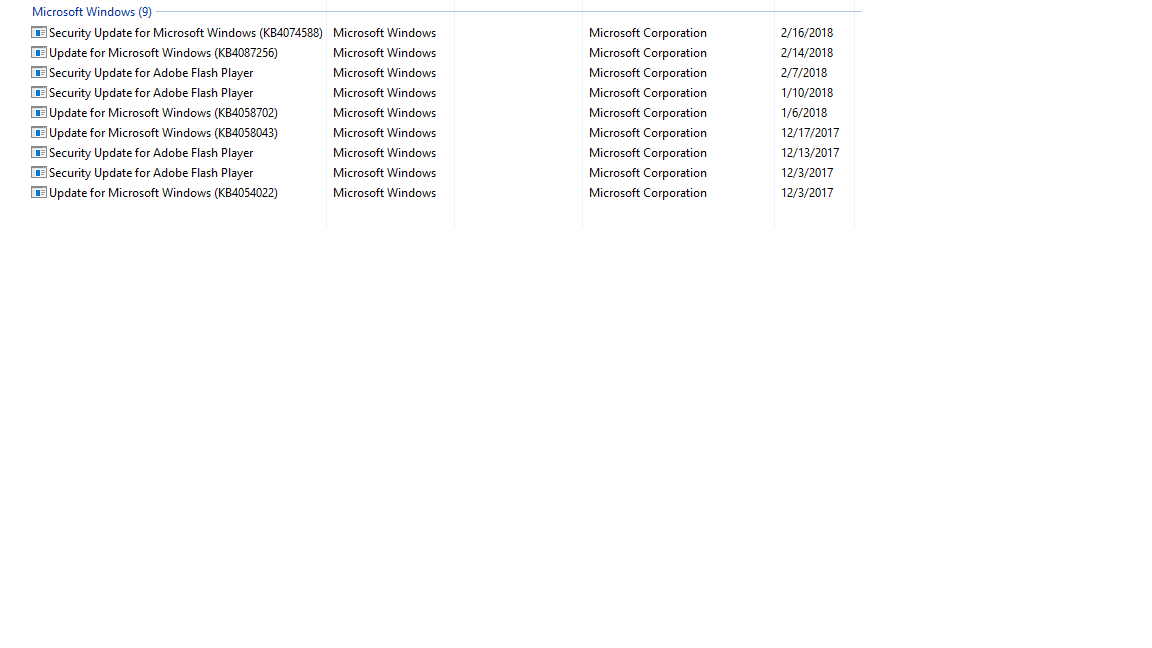

    So, now when I check update status, and check for updates, settings update says system is up to date.
    Control panel programs and features shows KB4074588 installed today.
    But the update history in settings update shows KB4074588 as awaiting restart. Before I did the SC command, it had shown KB4074588 as failed.
    Below is screenshot from control panel.

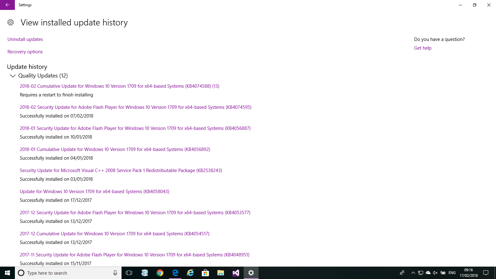

    1. Expect several restarts - the first one after using the command prompt does not work, the second one does - and it goes into it automatically whatever your restart settings
    2. The installed update screen is incorrect and tells you that you need to do another restart - not so - the message stays there irrespective of further restarts (screen dump attached)
    You know that everything has worked because (i) your see the updates install and (ii) when you check for new updates it tells you that you are up to date.

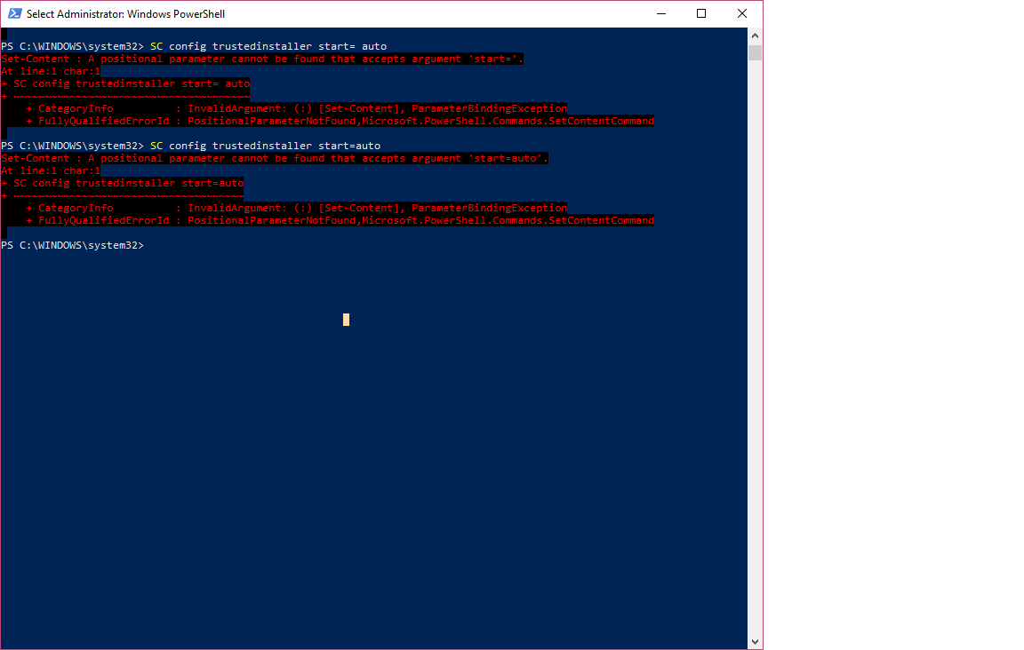

    Your propsal solved the original problem, however my computer rebooted a second time without warning unexpectedly after putting in the command and rebooting.
    Do I need to do something with the the configuration to avoid unexpected reboots later at other updates?
