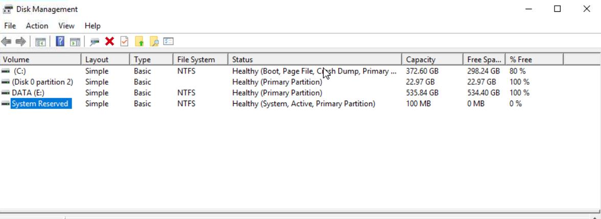

    no "Volumes tab" in the Properties for the System Reserved Partition.
    The Volumes tab is associated with the Properties of a Disk.  How many Disk do you have?  Note that the picture only shows the right-click of a Disk with the Properties item that you would have to click to then see its Volumes tab.
    Looks like the GPT or MBR thing is another one of those "it is not what it might be converted to" things, so if you see Convert to MBR in the Disk right-click menu I would assume it would be GPT and vice versa.  In fact, the Volumes tab confirms that idea.
    HTH
    Robert
    2018-07-10T14:34:41+00:00
    Yes I am able to access the Properties of System Reserved Partition by right-click. Other tabs are available in the System Reserved Partition properties and I inspect each tab but there is no Voumes tab and no reference on any of the other  tabs to MBR or GPT.
    2018-07-13T00:15:08+00:00
    How and why did my System Reserve partition get full?
    I was able to answer this question by using the "change drive letter and paths" option by right click of System Reserve Partition. By adding  a drive letter I was able to view contents in File Explorer. In this way I discovered that at some point in June a computer help person had for some reason stored some back up data files on my System Reserve Partition and so I was able to free up the space by moving the data somewhere else. Then I could also remove the drive letter once I was done to avoid confusion.
