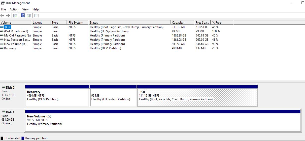

    I'm having issues with this error with the "2020-04 Cumulative update"
    • Partition space
      • I have no Idea which partition is the reserved to see if that is the issue. Image is of my OS(C:) drive
    • Method 1
      • I'm posting this from the computer that is having the issue so I don't think that is the issue
    • Method 2
      • Mine don't have check-marks the are black squares and can be expanded and when expanded there are items without check-marks.
    • Method 3
      • Have not tried this, but I want to try other things before I try to turn off the firewall
