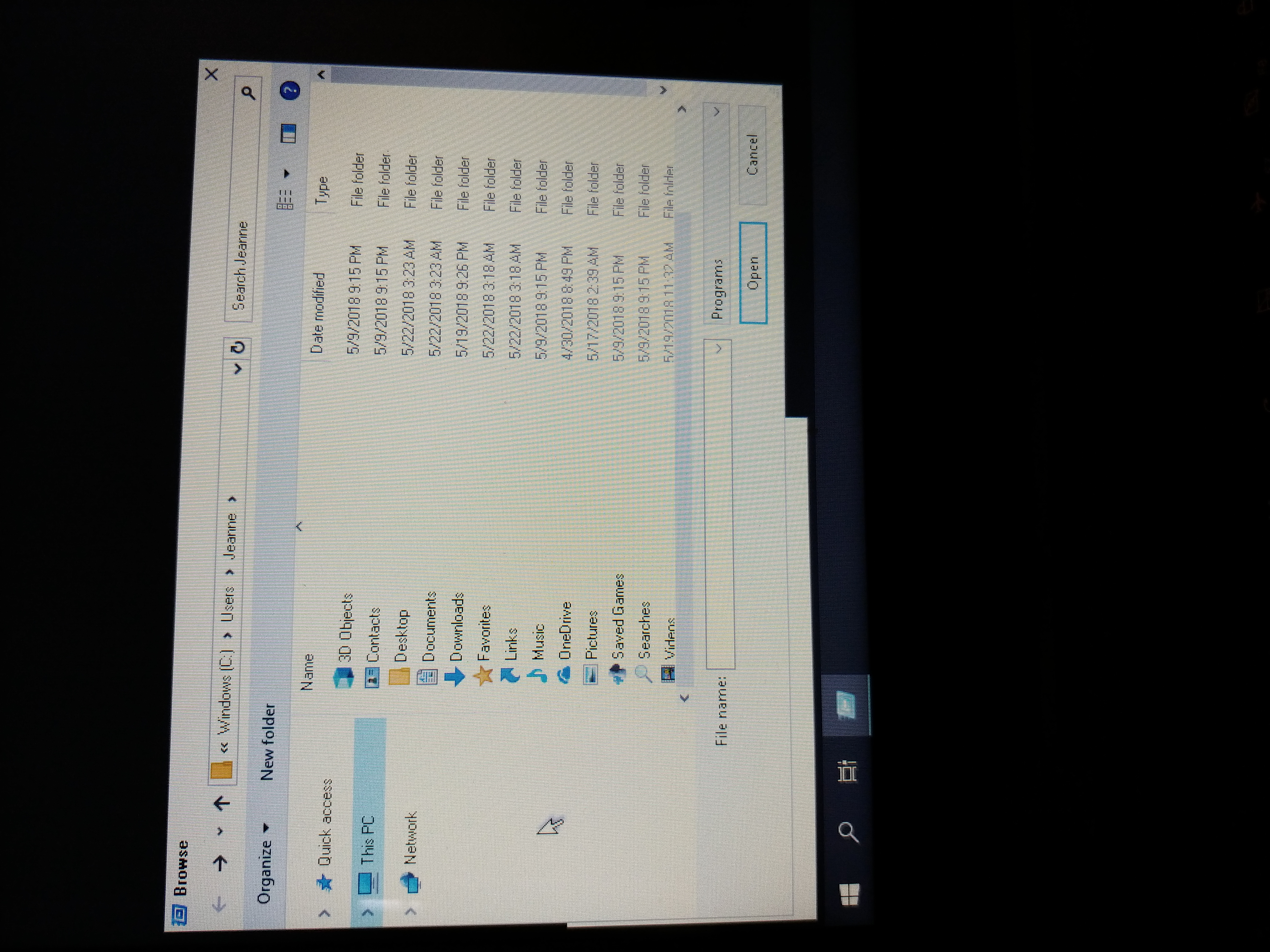

    2018-05-23T11:27:57+00:00
    So somehow I got onto my pc, but it doesn't have a desktop. I get this error when I try and access it. I can't directly access C drive but I can use the browse feature in the Run window or the 'run new task' under the file menu in task manager. Does this help at all? Can I fix anything from here?
