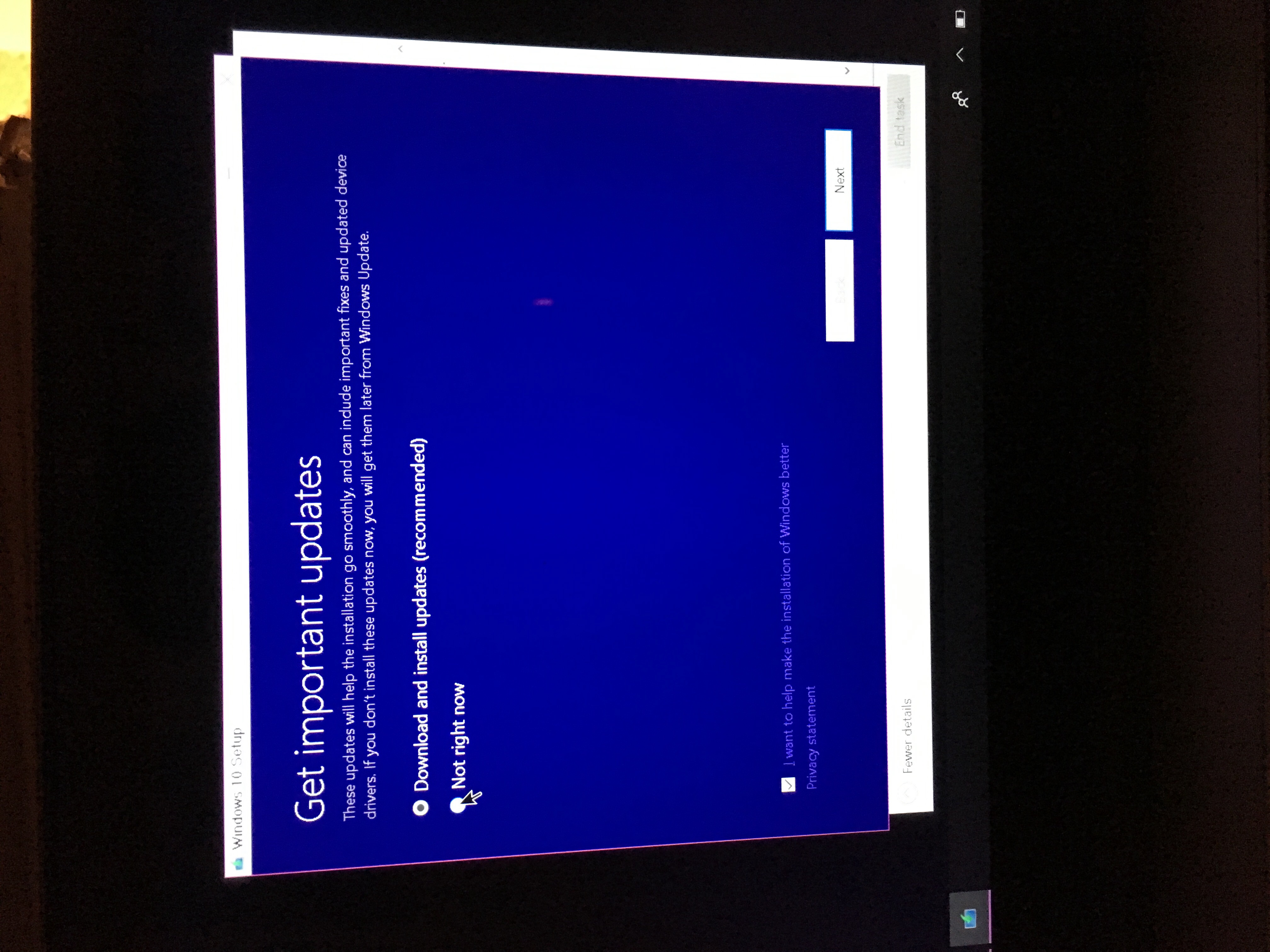

    2018-06-09T10:26:52+00:00
    when i get to step 15 im given two options
    1. download and inatall uodates (recommended)
    2. not right now
    which one should i choose?

    2018-06-05T02:25:29+00:00
    I got it to work! There is hope!
    I had to install the ISO onto a USB. I selected the option of booting to the windows 10 already installed. As many of you know, this takes you to a hollow ghost of what your OS should be. From there, I opened the task manager and chose file > run new task > browse. In the file explorer that pops up, select setup.exe and right click it, choosing run as administrator.
    The setup utility ran as designed from there. I was able to save all my files and apps! It took about two hours to complete. This is by no means an exhaustive step-by-step explanation, but it should give you enough to get where I did. Good luck!
