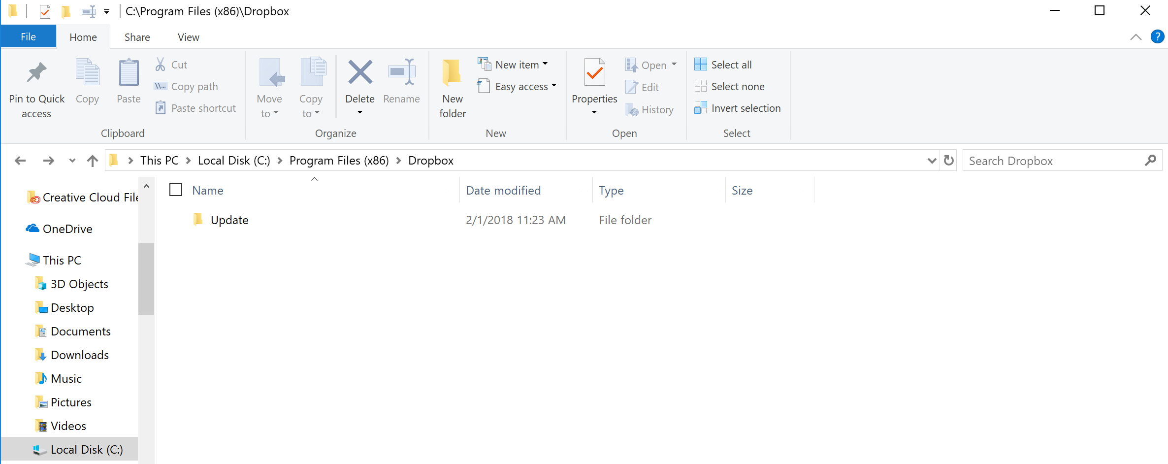

    2018-02-04T14:00:33+00:00
    Nope. I put a screenshot below of the remaining DropBox folder: the Update folder is empty.
    I have not rebooted since uninstalling so maybe somehow Dropbox is lingering.
