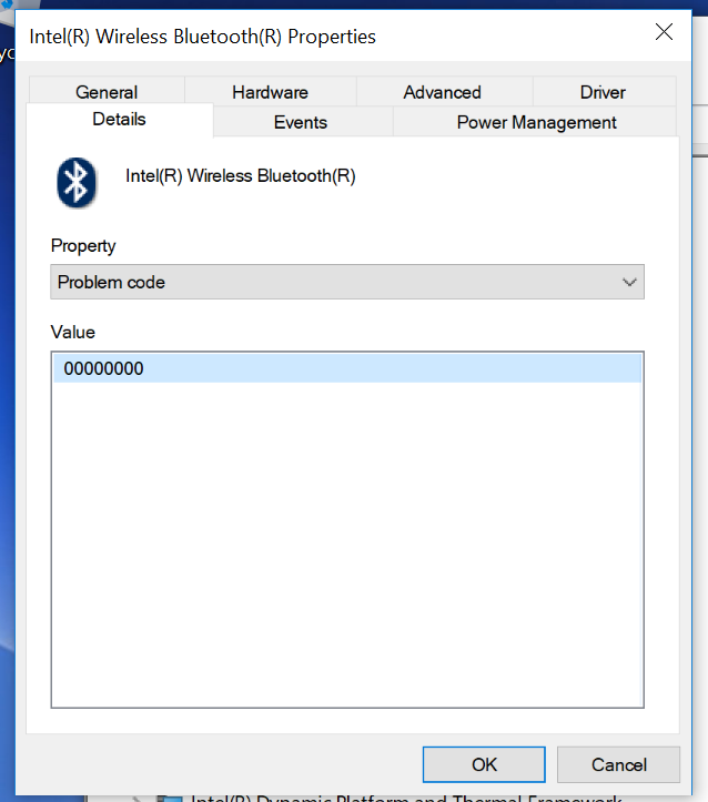

I've been using a Bluetooth keyboard with my Windows 10 laptop for months. Suddenly it wouldn't connect, and I made the mistake of removing it from my Bluetooth devices before discovering its batteries were dead. Now, with new batteries, it won't pair.
The problem is that when I go to Windows Settings and select Add Bluetooth or other device and put the keyboard into pairing mode, it shows up in the Add a device dialog, but when I click it, it says "Connecting..." for a long time and then says "Check the PIN and try connecting again."
That's not the way it's supposed to work! That Add a device dialog is supposed to give me a PIN and then I'm supposed to type it on the keyboard. So I have no way to proceed and complete the pairing.
Troubleshooting steps I have done so far.
  • I've tried the process repeatedly.
  • I moved the keyboard very near to, and then many feet away from, the laptop.
  • I moved the laptop and the Bluetooth keyboard to other locations in house, further away from other wireless devices.
  • I turned off all other Bluetooth devices in house.
  • In Device Manager I deleted everything under the Bluetooth category, selecting to delete the driver files also, and rebooting. (After reboot, everything comes back by itself.)
  • The laptop vendor support app, and Windows updates, say the laptop is up to date.
  • I swapped Bluetooth keyboards between two PCs. This keyboard paired to that PC without issue. The PIN appeared, I typed it on the keyboard, and done. That keyboard from the other PC would not pair on this laptop, displaying the same issue as the other keyboard did.
  • I have seen the solutions offered by ThomasFulton and Hanuki4 in this thread on this forum, but I don't get the same dialogs that these answers refer to, so am unable to use the info.
