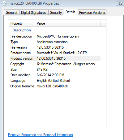

Search your system for MSVCR120_CLR0400.dll and when you find it check the Properties like this example:
What is the version on your system?
Whatever the version is, write it down and then come back and tell us what it is.
The files get installed with the C++ 2013 Redistributable package and is not part of a Windows installation so it is doubtful sfc  /scannow will help you.
Inside these DLLs are functions and the programs that are complaining are telling you that they are not finding the nextafterf function inside the MSVCR120_CLR0400.dll but as you can see on my system with my installed version of the file it is in there:
Apparently your MSVCR120_CLR0400.dll is afflicted, the wrong version or something else is not right about it.

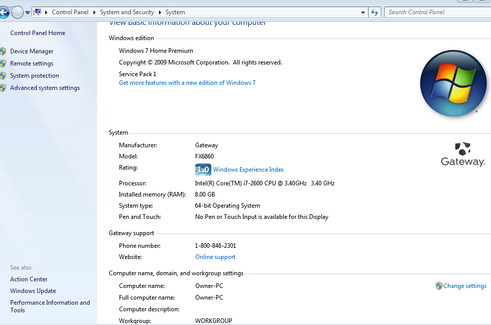

    Here is my error, my version, and system information.  How can I fix this error.
    entry point nextafterf could not be located in the dynamic link library msvcr120_clr0400.dll
    Thank you
