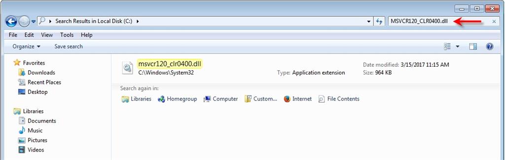

Search your system for MSVCR120_CLR0400.dll and when you find it check the Properties like this example:
What is the version on your system?
Whatever the version is, write it down and then come back and tell us what it is.

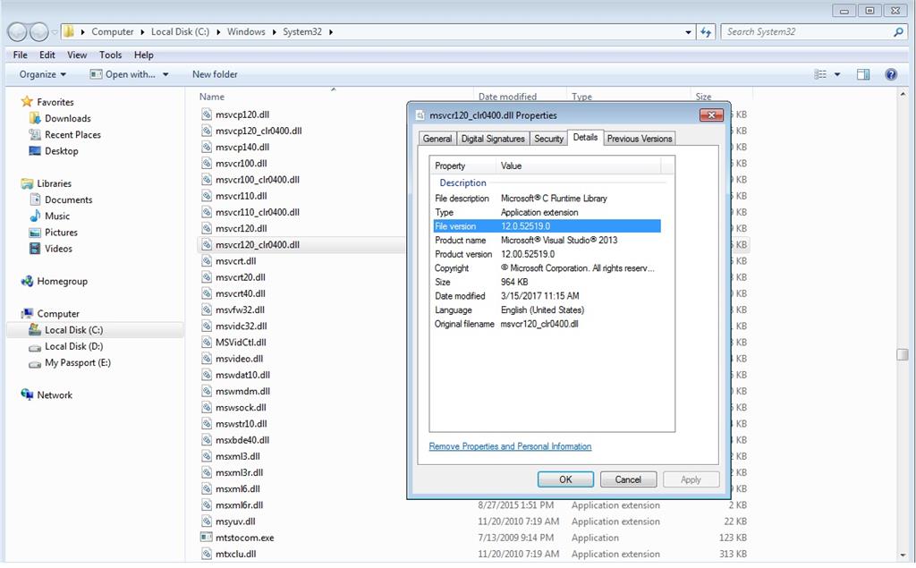

    So after going back to 4.0 were you able to (using the methods above) peek inside the MSVCR120_CLR0400.dll and find that nextafterf is in there?
    Will you post a screenshot of the details of the MSVCR120_CLR0400.dll that works?
    Click for instructions on How to include a screenshot in your post
    It should look something like this (but probably a different version):
    2017-07-04T11:31:04+00:00
    Hello, so,
    I can confirm that the previously relevent dll file does NOT contain 'nextafterf' so it appears that may have been a wild goose chase. Here is a screen shot of the properties.
