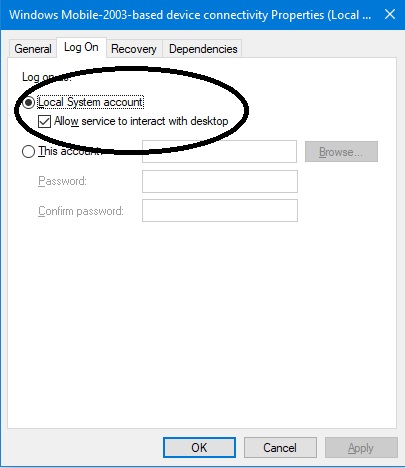

Now go to the Services applet, and look for the "Windows Mobile 2003-based device connectivity" service. Double-click it to view it's properties, choose the "Log On" tab and select "Local System account" as the log on mode.
You should now be able to start the service and WMDC will work as expected again.
