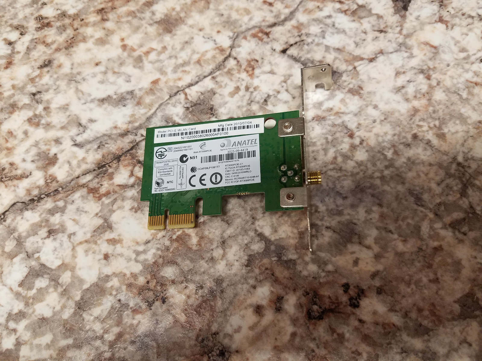

Finally, based on various hints on forums, I cracked open the PC and pulled out my PCIe wireless card. Boom. Fully installed.
The Wireless card was a PCIe x1 in a PCI x16 slot if that matters, and it was the ASUS branded MediaTek Railink technologies RT3090 wireless card.
(PCI\VEN_1814&DEV_3090&SUBSYS_760111AD&REV_00)
Once the Creators Update was installed, I was able to reinstall the card without incident. Go figure.

One commenter noted that moving the card from a PCIx16 slot to a PCIx4 slot also fixed the problem, so it may be an interaction between the card and the northbridge (motherboard chipset) in certain slots.
EDIT: WARNING: Be careful removing and re-inserting the wireless card; make sure the power cord is removed from the power supply. The sound card chip is right at that slot and I damaged it, so now my system no longer recognizes when speakers are attached. Looks like I scratched a trace on the motherboard.  I know it is a hardware problem because booting a Linux Live USB showed the same problem.
