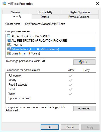

    If you have not yet done so, in file explorer navigate to Windows >System 32 >MRT.exe then right-click on MRT.exe and select properties. In the General tab make sure that the Read only checkbox is clear. In the security tab you can check what the permissions settings are for your account.

    We are stuck at this point in time.... RikDatta, is unable to execute a MRT scan in the run box.  He was previously able to do this.  A message is prompted "System Administrator has blocked this app from running" ...but RikDatta is the Administrator of his computer.
    We have tried some strategies all unsuccessful so far.  Any suggestions?
