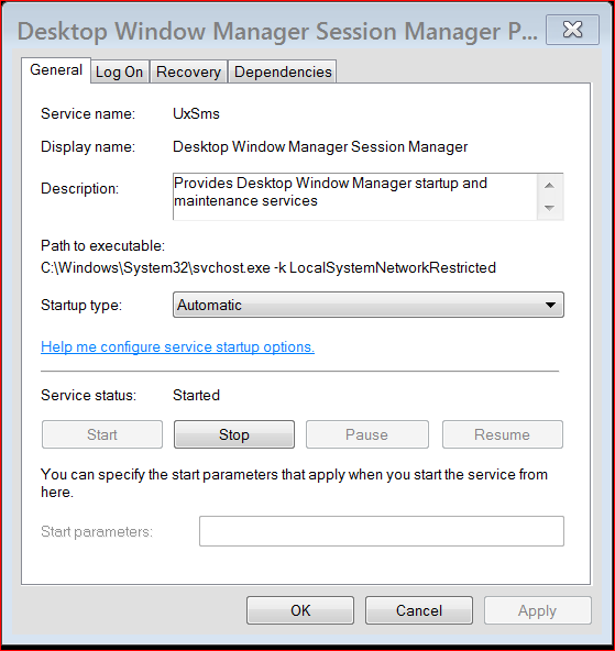

First make sure the Desktop Window Manager Session Manager Service is running.
Click the Start orb/button and enter "services.msc" to open the Services applet and choose to Run as administrator:
Locate the Desktop Window Manager Session Manager Service, double click it to open the Properties and and be sure the Startup type is set to Automatic and that the status is Started.  Make any adjustments so it looks like the example and click the 'Start' button to Start the Service if it is not running:

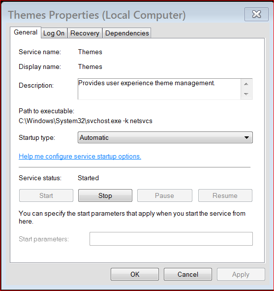

Next check the Themes Service which should look like this:
If it doesn't look like that double click the Themes Service to open it's Properties and see if you can start it.

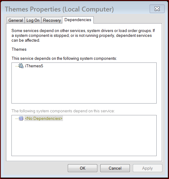

The Themes Service should have no dependencies so if yours does then something or somebody must have added something as a dependency.  You may not may not see things listed under the Dependencies tab for the Themes Service so let's check and fix it another way.

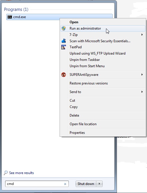

Open a Command Prompt as Administrator:
Click the Start orb/button and in the box enter the following:
cmd
Right click cmd.exe and choose to Run as administrator:

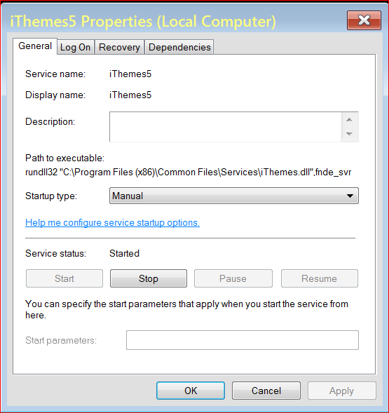

Lately there have been incidents where the Themes Service has a Dependency of iThemes5.  The iThemes5 dependency could have been added by some third party software, malware or adware and if/when that software was removed the iThemes5 Dependency was left behind.
An example of what that situation looks like is here:
Since there is no iThemes5 Service you will see this when attempting to start the Themes Service:

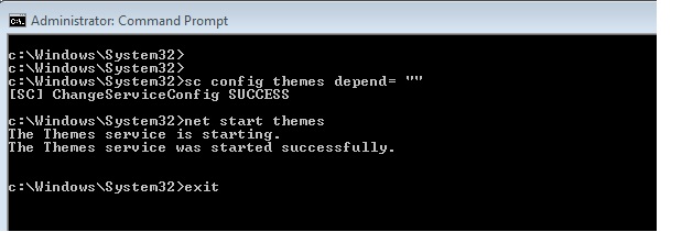

Since the Themes Service has no dependencies you need to remove all the dependencies from the Themes Service.
To do that issue this command being sure to include the space after the equals sign:
sc  config  themes  depend=  ""
Unless something else is wrong now you should be able to start the Themes Service with this command (or from Services):
net  start  themes

    I have here themes working and NOT working randomly. Please see my screenshots , taken when it is working. Yes the "bug" iTheme5" has entered my system somehow and now sitting in the Services listing. Please help.
    Please explain sequence of actions I have to follow to get rid of this IThemes5 bug.
    net  start  themes

    ElderN,
    It worked ! Sorry to have repeated the "same question" for the "same answer".
    I do understand that many have and will in future be here to seek this solution, but I thought I had here something unique as I found the behavior "random" and thought it might have needed some further tweaks.
    But thank goodness your excellent solution covered it all and my themes are behaving normal. Possibly the same or some other bug messed up Notifications Icon behavior also, which required further search and destroying remaining bugs and fix the registry. Now everything is really back to normal !!!
