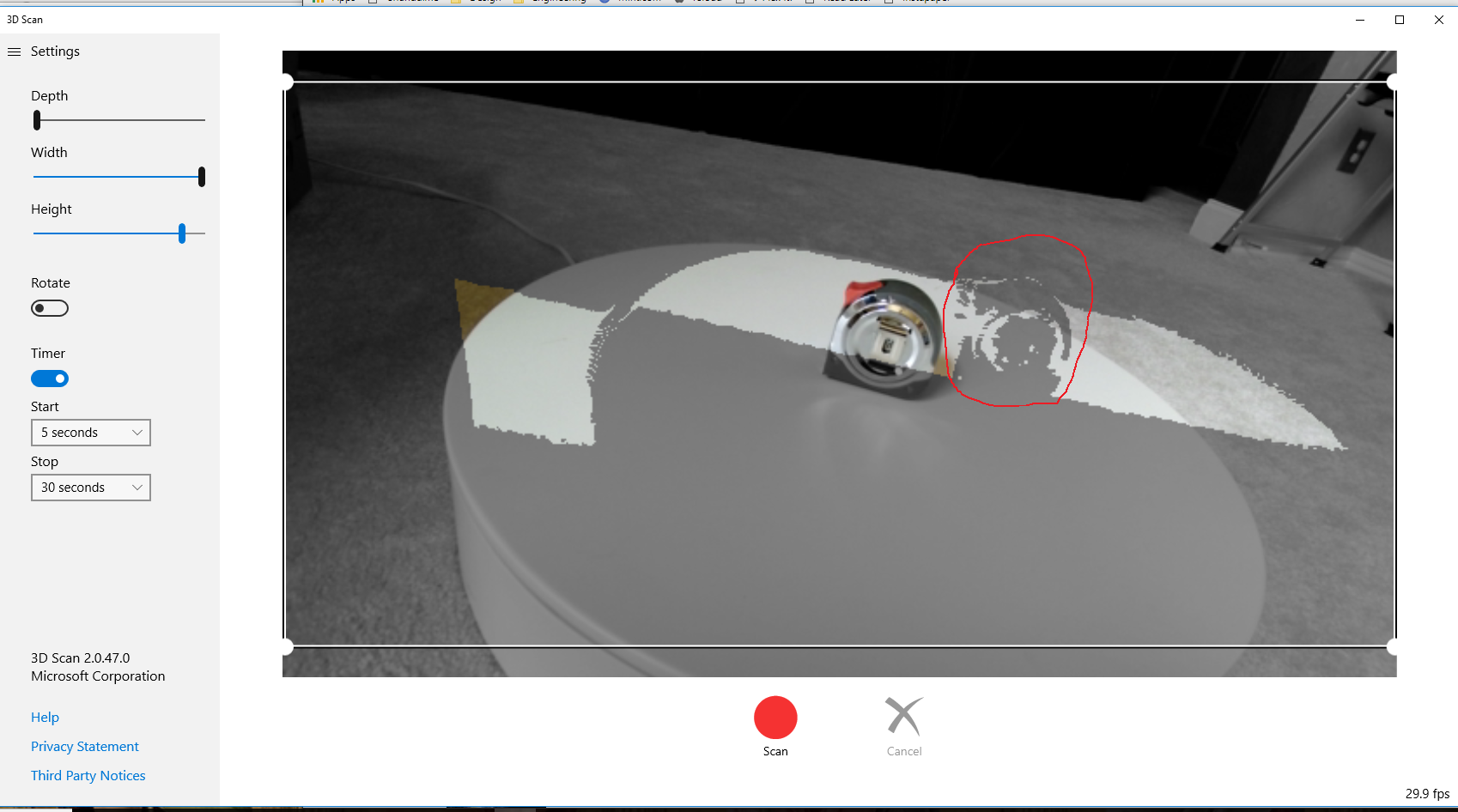

    Hello CBGrant [MSFT],
    I am having the same issues that Matias Migo had.
    I followed your instructions, changing the depth, but the scan comes out only partially, (like Matias showed in the photo) although in the preview everything is colored.
    Moreover, if I take a scan of the front view, without rotating around the subjects, it says there is not enough information to create the model, while in the previous version it was possible and it worked perfectly.
    Also, as for my art practice I am very interested in low resolution scans, and I appreciated the fact that in the previous version you could adjust the resolution. Is there any way to change the settings and be able to play with resolution?
    Or even, any way to re-install the old version please ?
    Many thanks
    Marco
    2017-08-11T18:02:44+00:00
    Marco,
    With your scans is the Kinect stationary or rotating around the object?
    Matias' problem was an incorrect depth setting and I think your problem might be the same.
    Remember to use your hand to find where the depth ends. Move your hand slowly away from the Kinect until it turns grey. If the Kinect is stationary and the object is rotating make sure, and this is important, that the Kinect does not see anything that is not rotating. If it catches a glimpse of a stationary wall or chair, the scan will be incomplete or partial like you are seeing. If the Kinect is rotating around the model then make sure you set the depth to be able to see everything you want scanned and walk around the model.
    Unfortunately, you cannot adjust the resolution settings in the current version and there is no way to re-install the old version.
    Let me know if any of this helps. If it doesn't please attach pictures like Matias did so I can get a better idea of what is happening.
    Thanks!
