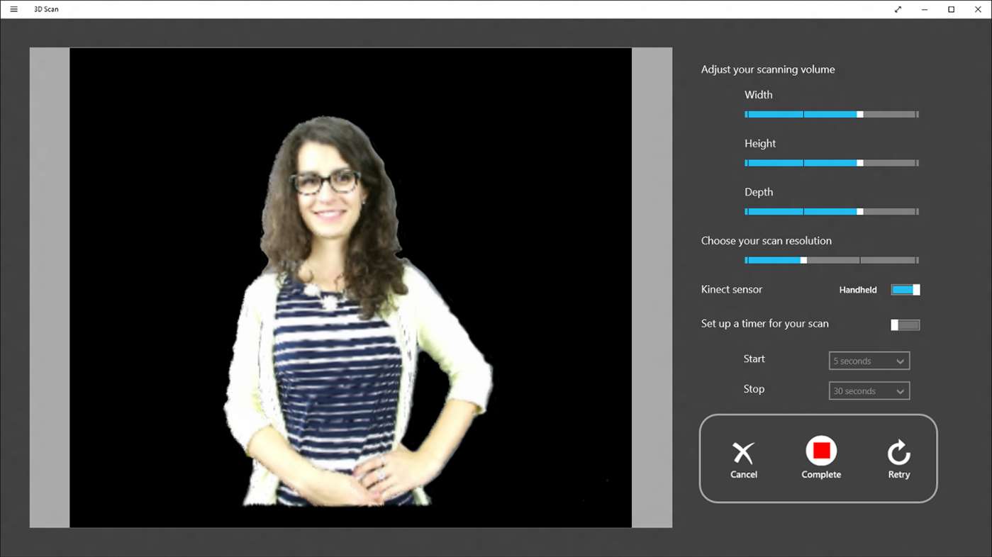

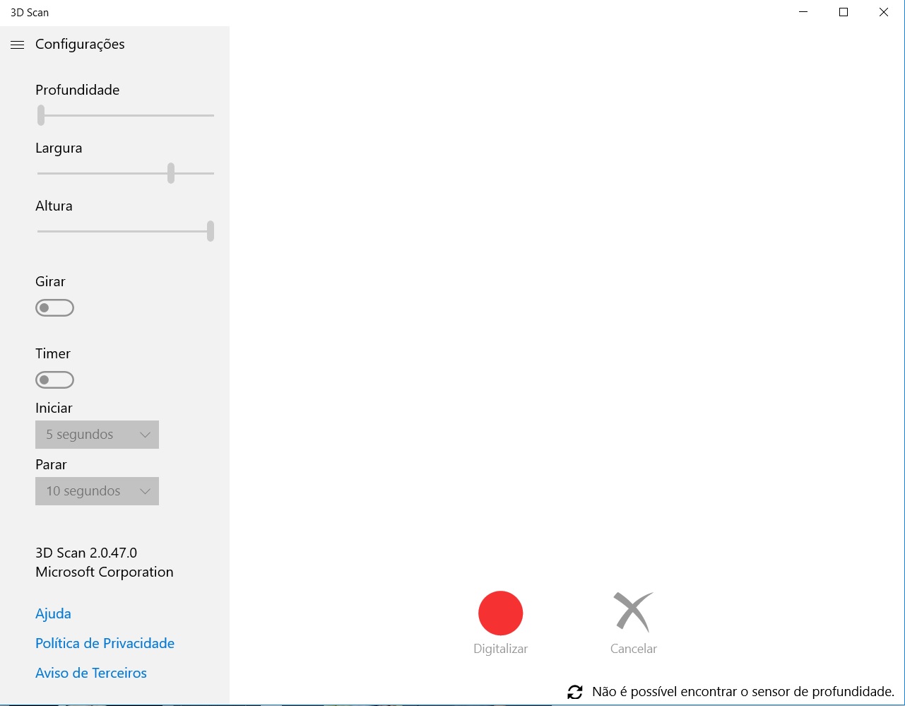

    Hello, where is this "Tips for best scanning results"? If it exists please send the link. I could not find any configuration for this app.
    I have some other questions about 3D scan:
    -Where 3D SCAN saves files?
    -Why do not any of the configuration options appear on my 3D SCAN as shown in the screenshots of the application presentation (see attachment: 1.jpg - as stated; 2.jpg - my application screen).
    -When I finish scanning the application closes and I can not find the job anymore.
    -I could not find any tutorial on how to configure and use 3D SCAN. You do not have any complete information.
    2018-05-22T20:25:29+00:00
    3D Scan saves files wherever you tell it to. It pops up a file explorer so you can choose where to put it.
    The app has been updated since it was originally released. That is why 2.jpg looks different, it is the newer version.
    That sounds more like the app is crashing, not closing. When the scan finishes you should be offered the option to view the scan in 3D Builder or save the scan file.
    There isn't a tutorial but there are some tips and tricks on our webpage: https://developer.microsoft.com/en-us/windows/hardware/3d-print/scanning-with-kinect

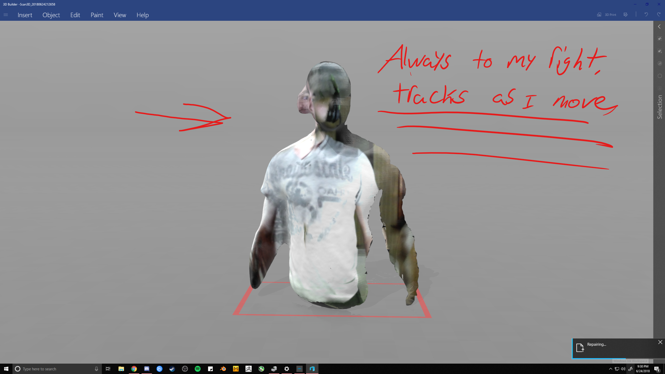

    Hi there! I'm currently experiencing an issue with the app.  the depth perception seems misaligned with my body, however body tracking works just fine with my SDK.
    Photo here
    2018-06-25T16:29:06+00:00
    Luke.
    Someone else in this thread asked the same question. Here is what you do:
    If the object and the colors aren’t matching up in your scans you can recalibrate the Kinect alignment. You can do this easily with these steps:
    1.       Plug-in the Kinect and open the Camera app
    2.       If you have more than 1 camera plugged into your computer change the settings so it is using ‘Kinect V2 camera’
    3.       Close the Camera app
    4.       Unplug the Kinect and re-plug it in
    Let me know if this works.
